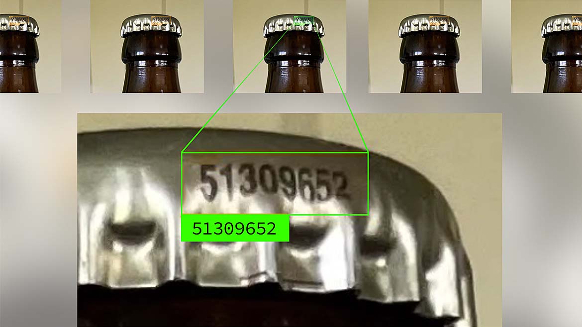

Heavily deformed and small numbers on crown caps.

Figure 1: OCR systems should read reliably from the outset in different applications, even without fine-tuning. For example, tire markings with little contrast, heavily deformed and small numbers on crown caps or information on separating discs with considerable overprinting, even with a highly inhomogeneous background.
