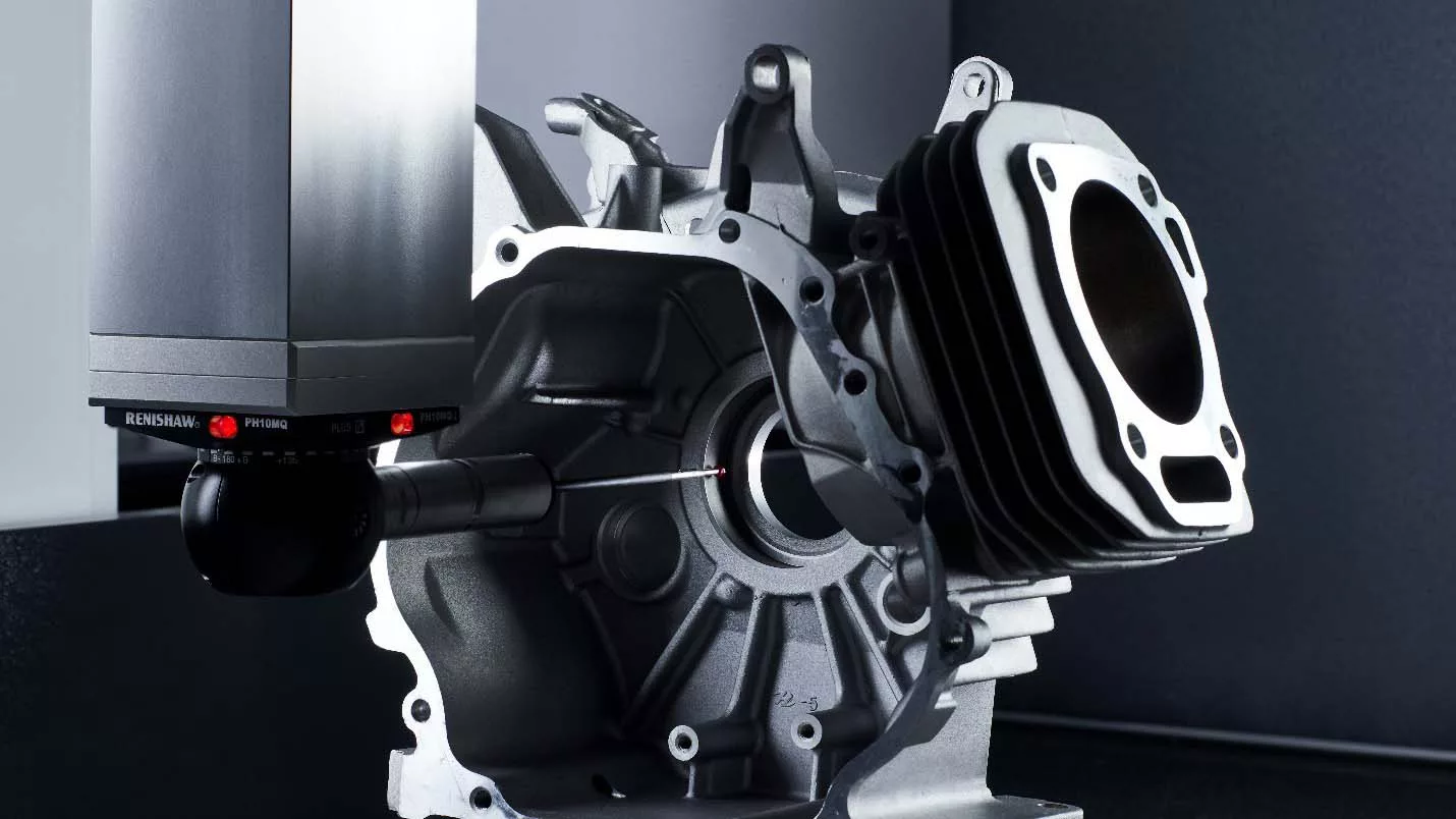

The first step is to write a new program with the bare minimum number of features and characteristics. The minimum here is going to be defined by the amount of adjustment parameters, i.e. CNC tool offsets, available to the process operator. Consider for example a small engine crank case cover made in two operations.   Each side has a set of holes cut in one operation.
Renishaw CNC tool offset
The engineering print may require all characteristics, but the shopfloor-savvy CMM programmer will know that he could break the FAI program down into two new programs, each focusing on one side and operation. In this way, if a machinist is looking for feedback on OP10, he doesn’t have to sit through half of the features he doesn’t need. In addition, only some characteristics can be fed back. While an interpolated bore at the crank journal can be controlled with CNC cutter comp using the CMM inspection results, the drilled bolt hole pattern can neither be offset for size, nor position. So an OP10 process control program would be slimmer still. It would not only skip all the OP20 features, but also all the uncontrollable features in OP10, such as drilled holes.

Consider for example a small engine crank case made in four operations. A typical characteristic may be the linear distance between the combustion face and the crank journal. A “simple” linear dimension, yet to everyone’s surprise, is out of spec on every preproduction part made. The combustion face may be cut in one operation and the crank journal in another. Each operation uses different machining datums to control the cut features’ positions. Adjusting one operation is useless without controlling the other operation using some common setup. In this example, a FAI program could take two hours to run, a great amount of time when the machinist just wants to know more about one single challenging characteristic.
CMM probe system
A shortened version of the FAI program would be a good first step. But it would not give the machinist insight into the root cause nor the solution. FAI programs, and abbreviated versions, can only tell staff that they are failing to meet engineering requirements, not how to get out of this mess. A much better program would report each feature to its machining datums, like a process control program, but also report the machining datums to the print datums. A few sample runs with this program would reveal to the machinist that his datum choices between operations are unrelated. An expert machinist might then solve the problem by keeping his work holding as-is, but using a CNC probe to pick up the same consistent datums on each operation. These probing features need not be the workholding datums, nor print datums, but any mathematically stable coordinate system.
