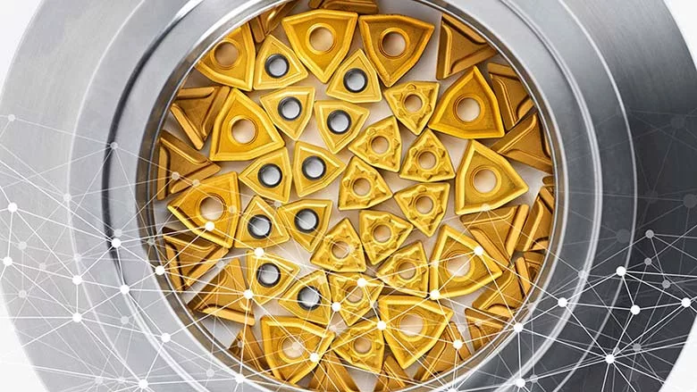

cutting tool inserts
Inserts come in myriad shapes, sizes and materials to match specific cutting and shaping applications.
Photo courtesy IDS Imaging Development Systems

Flexibility was a major challenge for the project. Inserts come in myriad shapes, sizes and materials to match specific cutting and shaping applications. The insert manufacturer offers some 2,800 inserts in its portfolio, which can be divided into almost 100 geometry families. Xactools needed to automate handling and inspection for all of them.
