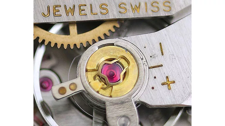

watch components and subassemblies
KIF Parechoc has been manufacturing watch components and subassemblies in Vallée-de-Joux, Switzerland since 1944.
