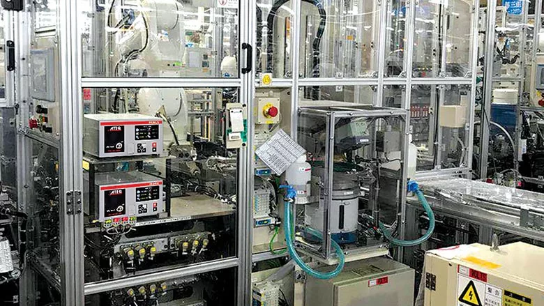

Engineers can get the best test system for their application if they provide as much detail about their project as possible. Photo courtesy ATEQ Corp.

Successful implementation of a leak test system in a production environment starts with clearly stated requirements. Some specifications are relatively easy: cycle time, test volume and how the parts will be handled. Others are less clear. What is the best method for testing the assembly? What is the leak-tightness requirement?
Engineers can get the best test system for their application if they ask vendors the right questions and provide as much detail about their project as possible. The key is to submit a clear and concise request for proposal (RFP). Failure to do so can cause headaches or delays, and lead to expensive mistakes.
