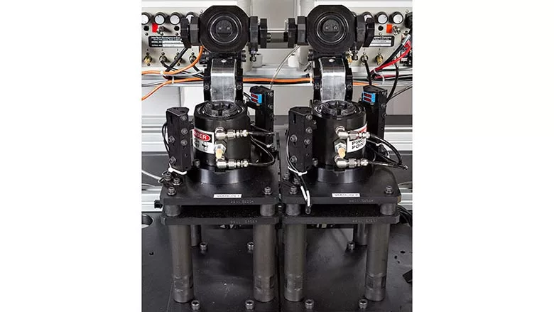

These test fixtures are used for fuel-related components.
Photo courtesy InterTech Development Co.
