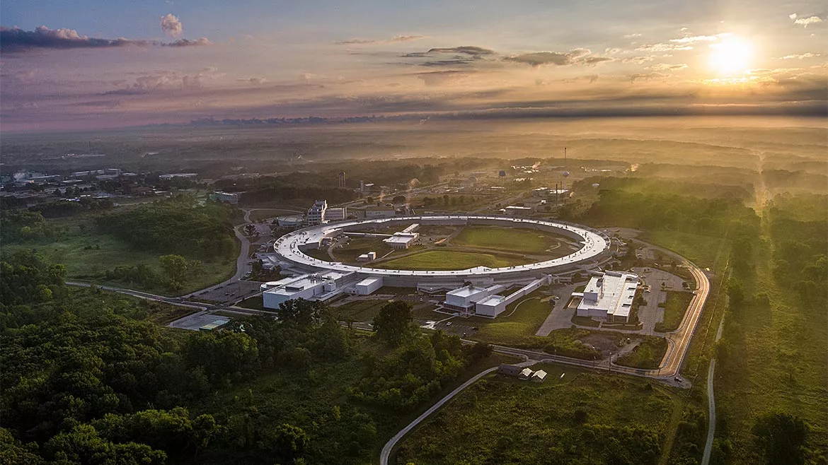

The Advanced Photon Source, a U.S. Department of Energy Office of Science User Facility, is in the process of a major upgrade, transforming it into one of the most advanced synchrotron light sources in the world. (Credit: Argonne National Laboratory/J.J. Starr.)
