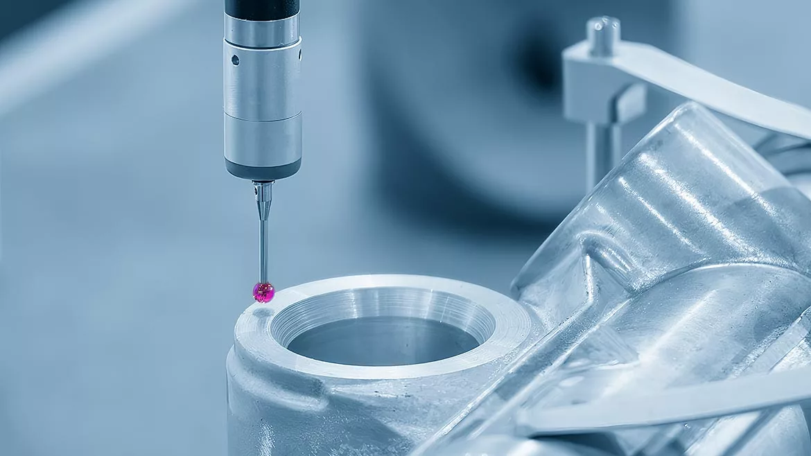

The CMM probe measuring the aluminum automotive parts.
