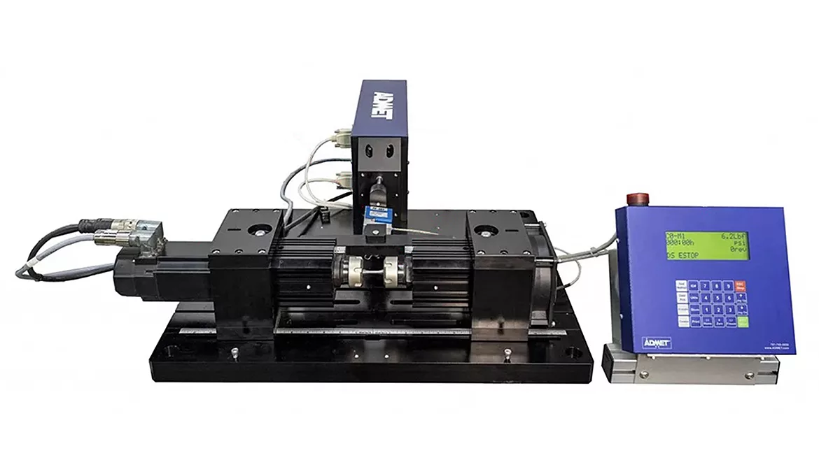

What’s In a Rotating Beam Fatigue Testing Machine?
In essence, rotating beam fatigue testing machines rotate a round test sample at very high speeds and apply a bending moment to it as it rotates. This setup creates fully reversed stress cycles in the material as it turns, often at rates up to 100 Hz, resulting in a more efficient means of applying cyclic stress to determine endurance limit (relative to uniaxial fatigue tests).
Shown in Figure 1, a typical rotating beam fatigue testing system includes the following components:
  • A central motor and spindle held by precision bearings
  • A pair of collets to securely hold the test sample
  • A loading mechanism, electromechanical or deadweight-driven, that applies bending moment
  • A load cell to measure and record the bending moment
  • A digital controller to control test parameters and record all data
Test Admet Fig1a: RBF Top-View
Image Source: ADMET
Figure 1. A dual pivot four-point loading rotating beam fatigue testing system with a servo controlled bending moment actuator. (Top and Front View)
Figure 1. A dual pivot four-point loading rotating beam fatigue testing system with a servo controlled bending moment actuator. (Top and Front View) Image Source: ADMET
Most modern machines allow users to specify rotation speeds from 600 to 6,000 RPM, which is useful for testing different materials and for studies that compare results at different speeds. Rotating beam systems can generally produce bending moments up to 50Nm (445 inch-pounds) and conduct fully reversing fatigue tests at up to 100 Hz cyclic frequency. Four-point- and cantilever-loading configurations are most common, and four-point loading is considered superior to single point cantilever systems because they produce a constant bending moment along the entire length of the specimen.  Rotating beam fatigue testing systems are commonly fit with a furnace to characterize fatigue properties across a range of temperatures.
