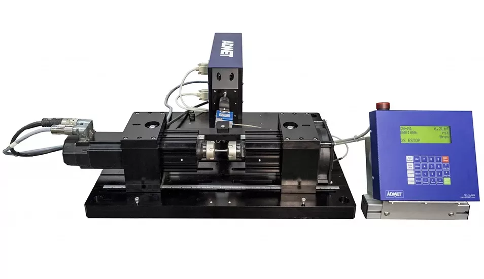

Rotating beam fatigue testing system with a motorized test fixture, specimen holder, and digital controller used for material fatigue and durability testing.
Source: ADMET
ADMET eXpert 9300 Series Rotating Beam Fatigue Testing Machine

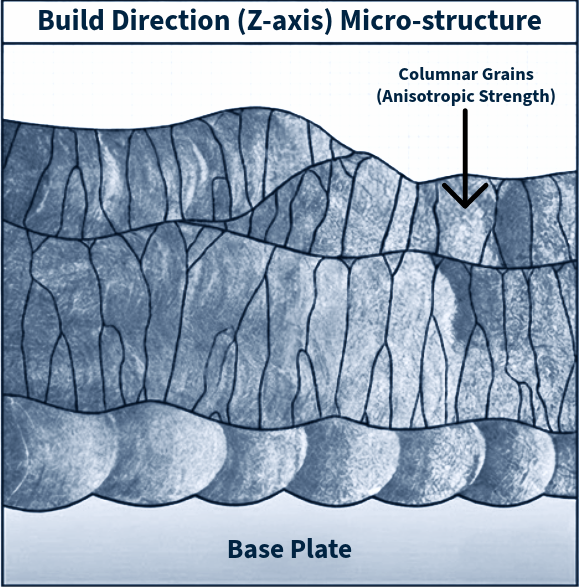

Microstructure and Anisotropy
AM parts are created via layer-wise solidification where the metal experiences rapid heating, cooling, and re-melting cycles. Many printed metal parts in the real-world are designed with complex geometries that are created through these heat cycles. As each layer is fused, a heterogenous microstructure develops which is more complex than a grain you would see in traditional metals. Instead of a uniform grain structure, you commonly get columnar grains growing in the direction of the build.
Illustration of an additive manufacturing microstructure showing columnar grain growth along the build direction (Z-axis), highlighting anisotropic material properties above the base plate.
Source: ADMET
This leads to anisotropy, meaning that the mechanical properties change depending on the direction of the load relative to the build orientation. For example, a part might be incredibly strong when pulled vertically (along the Z-axis) but behave differently when loaded horizontally. Consequently, standard qualification methods that assume material uniformity can easily overlook critical weaknesses in specific orientations.

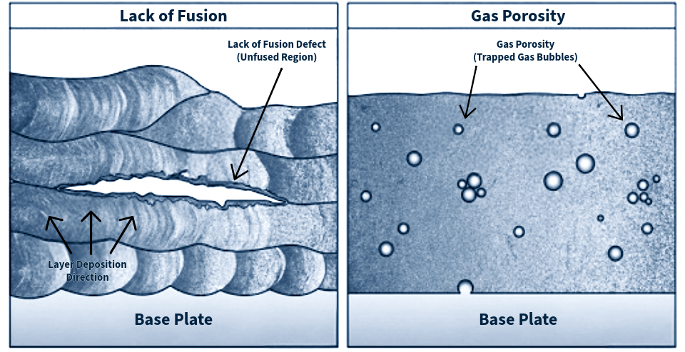

Gas Porosity and Lack of Fusion
We must also address the internal architecture. Even with optimized parameters, AM metals contain inherent defect populations. First, the “Gas Porosity” defect refers to the presence of tiny spherical bubbles trapped in the microstructure during solidification. Second, the “Lack of Fusion” defect occurs when irregular voids form in imperfectly bonded layers.
Illustration comparing lack of fusion and gas porosity defects in additive manufacturing, showing incomplete layer bonding and trapped gas bubbles within a printed part.
Source: ADMET
These aren’t necessarily signs of ‘bad’ manufacturing; they are often intrinsic tradeoffs of the laser-powder interaction in metal AM manufacturing. However, in a cyclic loading environment, these features act as microscopic stress raisers that compromise long-term durability. Consequently, the fatigue life of an AM part is often determined not by the strength of the metal itself, but by the size and location of its most critical defect.

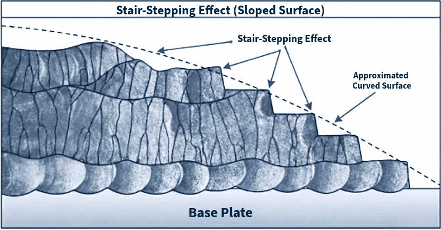

Surface Condition
Finally, the surface texture is often the biggest weak point for fatigue. Because 3D printers build in layers, the outer “skin” of the part is rarely smooth; it suffers from a microscopic “stair-step” effect and is often covered in leftover grit. To an engineer, this roughness is dangerous. Every tiny valley or scratch acts as a “stress concentrator,” or a pre-made starting line for cracks to form when the part is used.
Illustration of the stair-stepping effect in additive manufacturing, showing how layered deposition creates stepped surfaces when producing curved or sloped geometries.
Source: ADMET
While we can smooth these surfaces using traditional machining or high-pressure heat treatments, these aren’t magic wands. Polishing works on the outside, but it often cannot reach the complex internal channels that likely justified using 3D printing in the first place. These treatments improve the part, but they are variable corrections; they cannot hit a true “undo” button on the part’s thermal history or guarantee the uniformity of traditional metal.

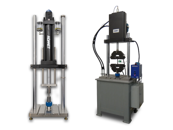

1. Follow a standard, and follow it well
While AM is a novel technology, the fundamental physics of testing remain unchanged. Adhering to established standards such as ISO 1143 (for rotating bar bending) or ASTM E466 (for force-controlled axial amplitude) is critical. Because AM materials inherently exhibit high data scatter due to internal defects, it is vital to minimize experimental scatter. Strict adherence to alignment checks, load verification, and gripping techniques ensures that the variability in your data reflects the material quality, not the test setup.
Two universal testing machines used for tensile, compression, and material testing, featuring vertical load frames, grips, and automated testing controls.
ADMET Axial Tension-Compression Fatigue Testing Machines: eXpert 5900 Series (Electromechanical) and 1900 Series (Servohydraulic). Source: ADMET
