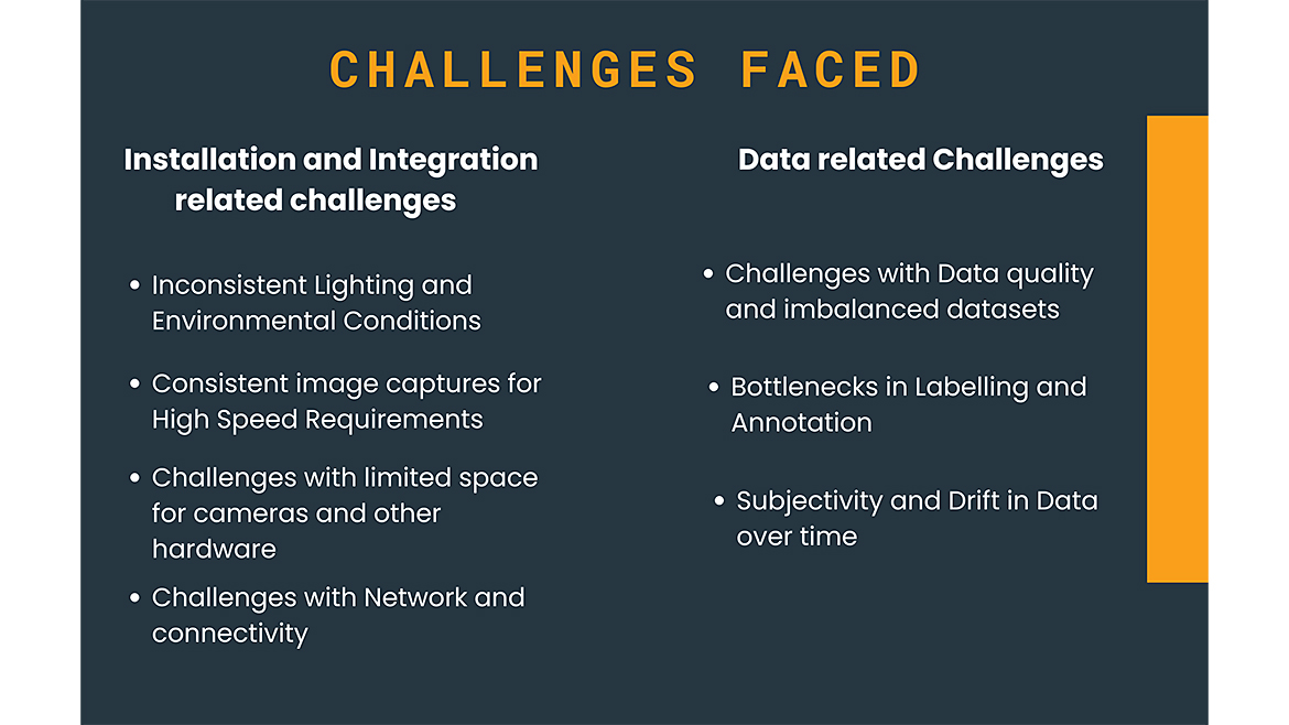

Infographic of 'Challeges Faced' for 'Installation and Integration related challenges' and 'Data related Challenges'.

Installation and Integration related challenges: Inconsistent Lighting and Environmental Conditions

Consistent image captures for High-Speed Requirements

Challenges with limited space for cameras and other hardware

Challenges with Network and connectivity

Data Related Challenges: Challenges with Data quality and imbalanced datasets

Bottlenecks in Labelling and Annotation

Subjectivity and Drift in Data Over Time
