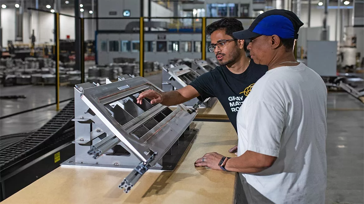

Employee pointing at a monitor screen.
Image Source: GrayMatter Robotics

Robotic automation delivers consistent quality. Human operators are prone to making mistakes when they experience fatigue and cognitive overload. When a company experiences significant labor churn in a tight labor market, it needs to deploy new workers with no prior experience. New workers tend to make more mistakes compared to experienced workers. Robots follow specified rules, so using robots helps remove most of the human variability error from processes. Automation can be highly repeatable and therefore improve the overall process. Robots reduce the need for rework and the amount of scrap. Less scrap means less landfill waste. Therefore, robots not only improve quality but also reduce waste.

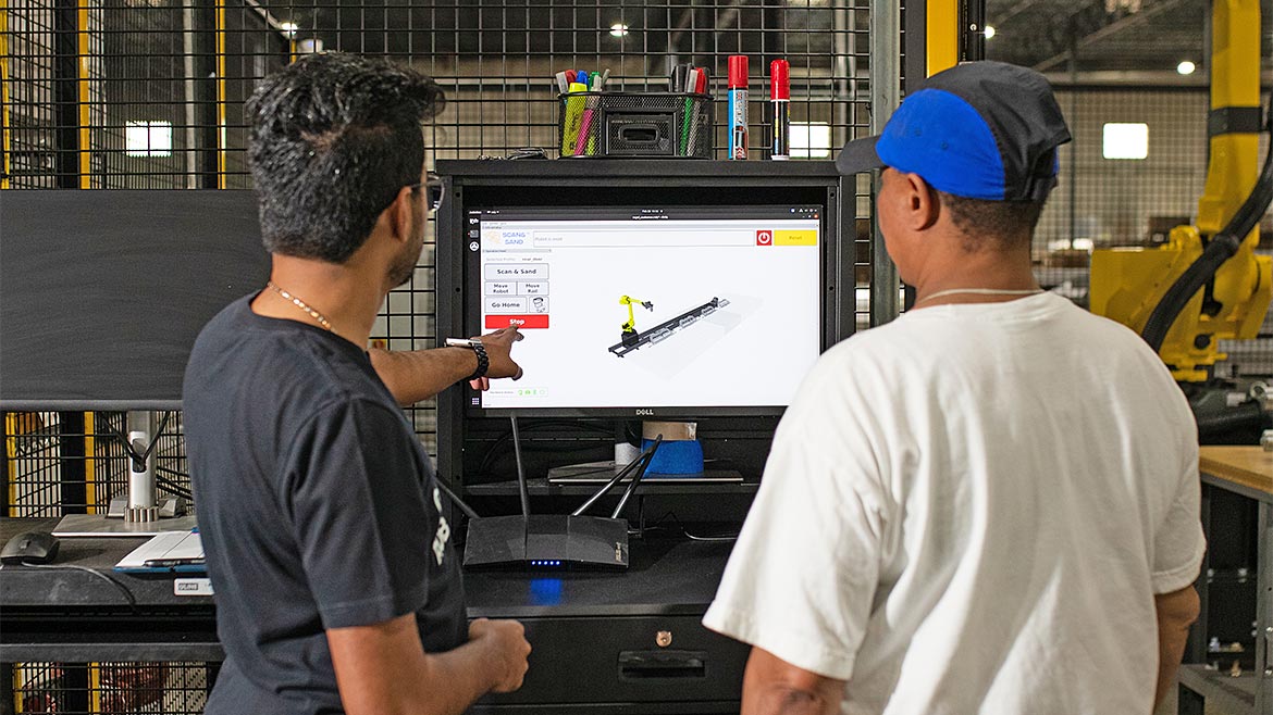

Using Digital Twins of Robotic Cells to Prevent Failures and Continuously Improve Process
Many robotic cells implement an inspection step to ensure that the part processing has been successfully completed. Inspection data can also be used to automatically construct a digital twin of the as-manufactured part. This model can be useful in efficiently automating downstream processing steps. AI-based prognostics and health management can leverage digital twins to ensure that the onset of adverse events are automatically detected so that corrective actions can be taken. For example, the digital twin can use the force and vision data to determine the cause of rapid tool wear in robotic finishing and take corrective measures to prevent it.
The need for continuous improvements and process optimization requires the system to build its own process model. A digital twin can use machine learning to safely conduct autonomous experiments and build a model for selecting the optimal process parameters for sanding a new material.
Two people looking at a computer desktop
