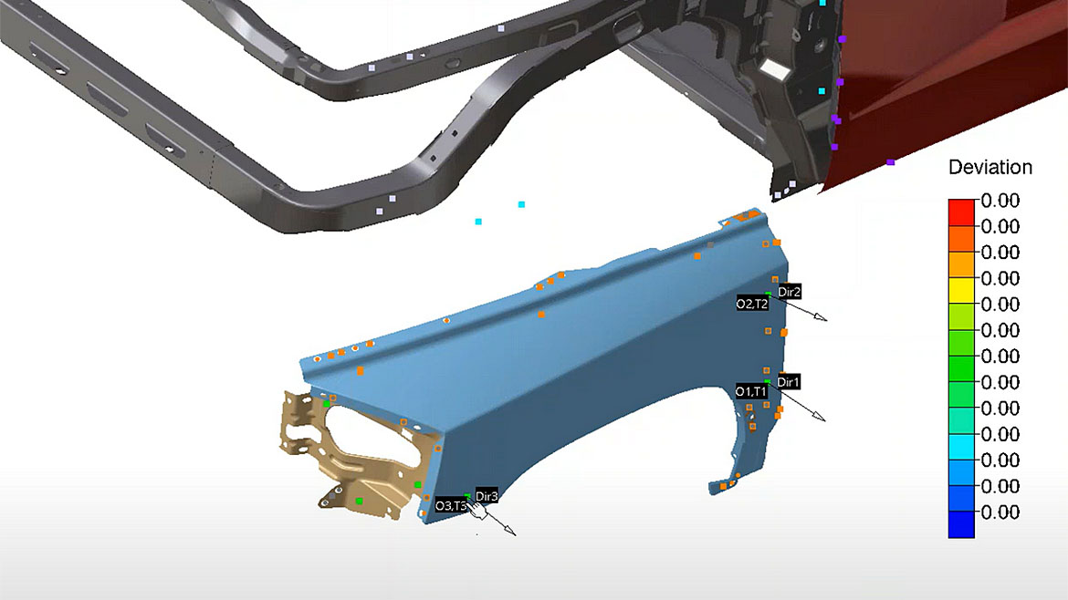

In order to illustrate the process of optimization, let’s look at an automotive fender and utilize both a dimensional analysis tool, 3DCS Variation Analyst by DCS, and a finite element analysis solver, Abaqus by Dassault Systemes. The analysis presented is illustrative and uses a hypothetical scenario. Actual outcomes may vary.
With an automotive front fender assembly, or any assembly, the first step towards optimization is the identification of critical tolerances, and the optimization of those tolerances towards manufacture and assembly. This provides a key understanding of which tolerances need to be controlled, and which may be ‘opened up’, that is, increased in range allowing less expensive processes to be used. Tolerances are further refined through optimization to find a set of tolerance ranges achieving the product specifications at the lowest cost. For the fender example, meeting the dimensional product specification while incorporating dimensional variation resulted in a cost increase of 20%, as critical tolerances had to be tightened, that is, decreased in order to still meet dimensional goals during assembly.

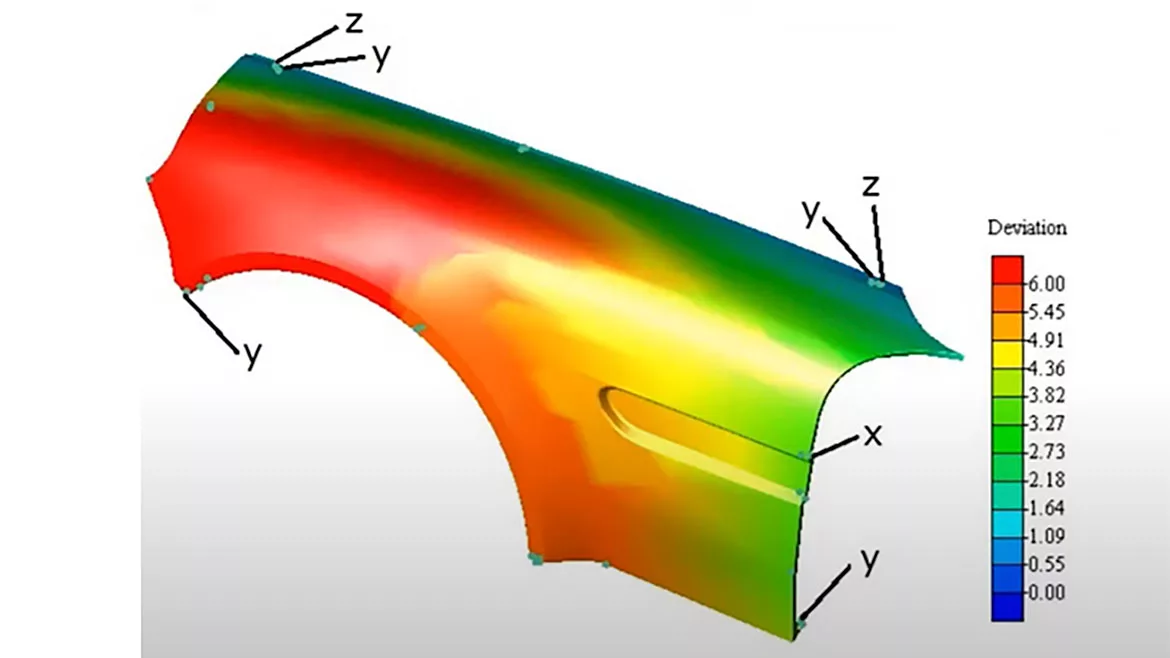

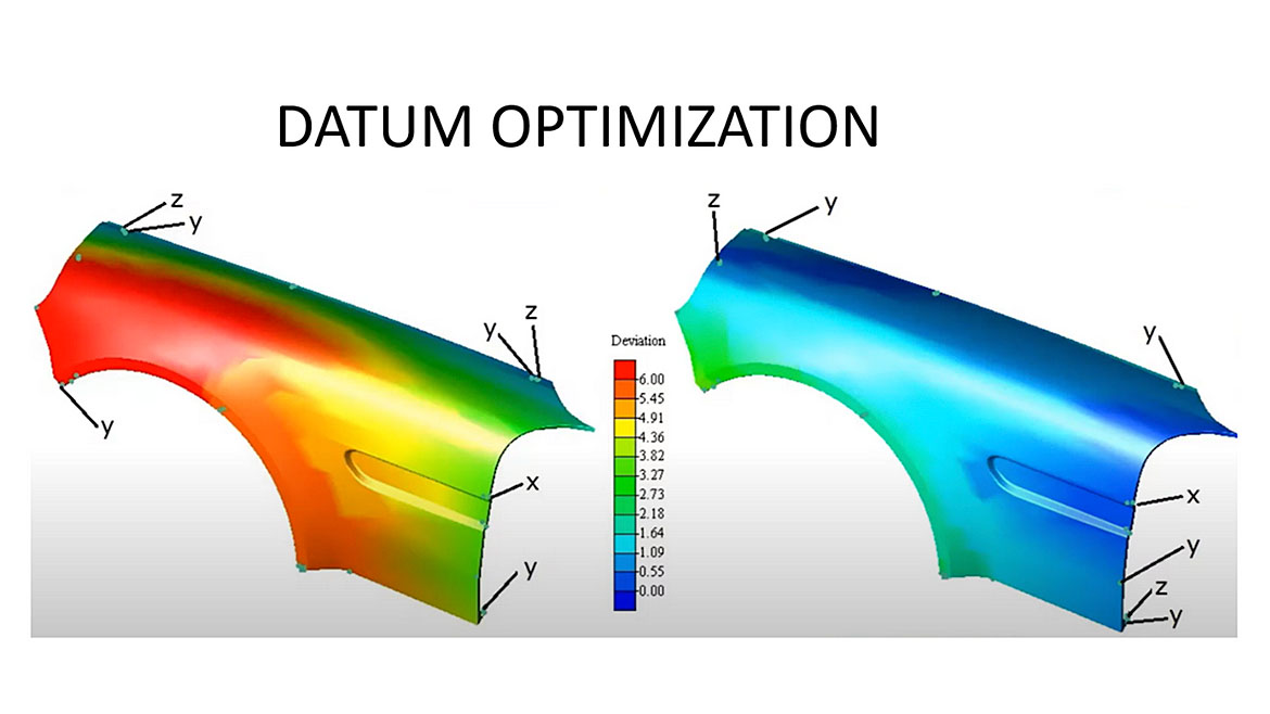

After optimizing the tolerance specifications, a locator optimizer evaluates datum schemes, testing each assembly move into a locator position with variation and measuring the resulting deviation. This identifies the most stable datum scheme and sets the stage for optimizing the clamping and welding process that can introduce variations into the sheet metal assembly. In order to predict the clamping and welding variation, a Finite Element Analysis software is applied. This combined both the material deformation with the dimensional variation allowing for a very accurate tolerance stack up analysis.
In order to optimize the clamping and welding sequence and added variation from material deformation, the primary, secondary, and tertiary datums as well as the sequence of clamps need to be analyzed. Compounding on this, the welds further increase variation as the heat deforms the sheet metal. In order to reduce this variation as much as possible, and keep the cycle time low, both the sequence and variation are incorporated into the optimization process. This assembly process optimization minimizes lead times by strategically determining the optimal clamp and weld sequences in design phase instead of using manual sequence studies on the plant floor.
Datum Optimization
Image Source: Dimensional Control Systems
Optimizing the tolerances again after the above optimizations finds a reduction in cost of 15%, while still meeting the dimensional product specifications. In order to combat the final 5% increase in cost found, other methods of cost cutting or revenue increases can be investigated. For example, the purchasing department may suggest an earlier product release to increase the sales window and emphasizing the “Jewel Effect” of the body, what they call the luster from a well-polished vehicle exterior that shines like a jewel. These combined may increase the volume of sales and offset the cost increase from design changes. Alternatively, the estimated reduction in scrap and waste by meeting specifications the first time, thereby improving overall yield, may also offset the cost increase. Both strategies ultimately optimized manufacturing and dimensional tolerances for the fender assembly, allowing it to meet design specifications during the design phase without exceeding the original cost.
