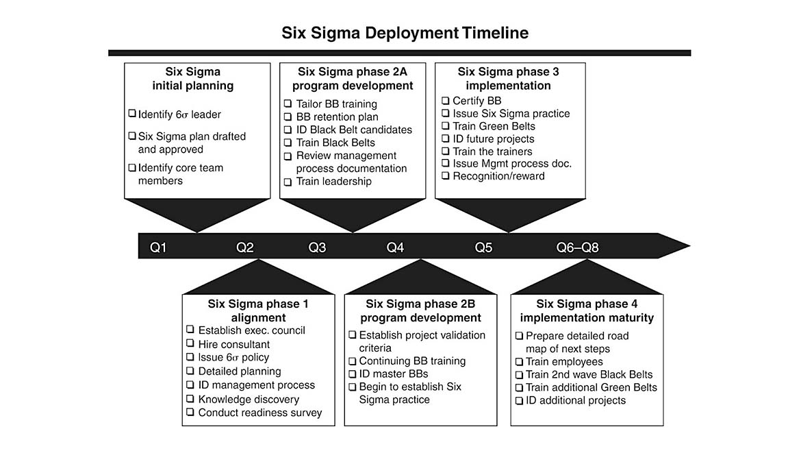

A typical deployment timeline is shown in Figure 2. Only after Champions have been trained, and the outcomes described above sufficiently realized (especially (g), regarding initial project selection), can the team members begin their training. Training for these participants is done on a just-in-time basis, coinciding with their participation in a specific LSS project. The project team is trained using their assigned project as a training aid to learn the necessary skills for project completion. Training follows the DMAIC cycle, so participants develop the project as they proceed through training, applying their new skills to the specific project at hand, strengthening their understanding and comfort with the tools and techniques. A purely academic seminar-style environment is a poor substitute for this real-world real-time application of the skills, and risks students losing retention of the material content. Online training has some benefits, such as 24/7 availability of the training material, which helps students learn at their own pace and work around daily commitments. The flexible scheduling of each topic allows for better integration of the training topics with the project development, by allowing time between sessions for critical project activities, such as data collection and team problem-solving meetings.
Figure 2: The Six Sigma Handbook: Sixth Edition, by Thomas Pyzdek and Paul Keller. McGraw-Hill (2024)
Source: The Six Sigma Handbook: Sixth Edition, by Thomas Pyzdek and Paul Keller. McGraw-Hill (2024)
Figure 2: Lean Six Sigma Deployment Timeline (The Six Sigma Handbook: Sixth Edition, by Thomas Pyzdek and Paul Keller. McGraw-Hill (2024)).
