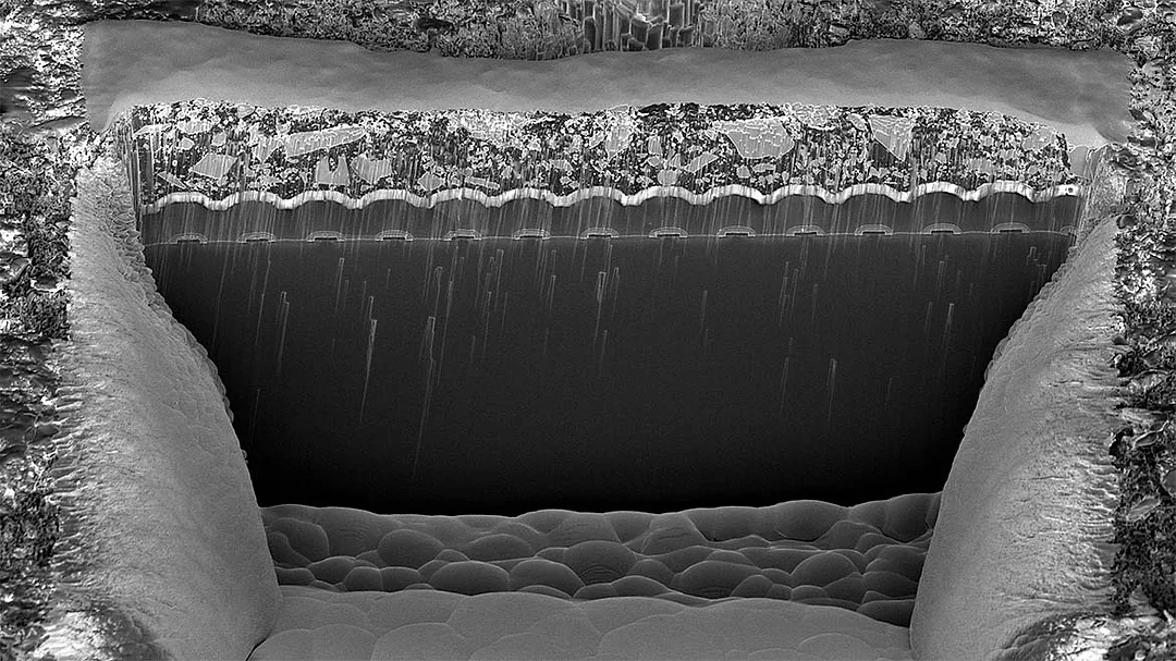

One major pain point in FIB milling is curtaining, which appears as wavy or grooved patterns on the surface of the milled cross-section, resembling the folds of a curtain. It often occurs when a sample has layers of different materials of varying densities, causing the ion beams to remove some areas faster than others. Curtaining can massively impact the quality of analysis as it distorts the real structure of the material and can obscure fine features such as thin layers, grain boundaries or defects.

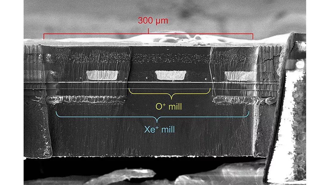

Gallium has long served as a favored choice for FIB systems, as it provides excellent beam stability and precise control. It is extracted from a liquid metal ion source (LMIS), which provides excellent beam stability and control. However, gallium can chemically interact with certain materials, leaving behind contamination, and its relatively low maximum beam current restricts throughput when working with larger samples or volumes.
By contrast, other ion sources such as xenon, nitrogen, argon and oxygen are generated using inductively coupled plasma (ICP) technology — collectively known as Plasma-FIB (PFIB) systems. PFIB instruments can deliver much higher ion currents than LMIS, making them particularly efficient for high-throughput milling while still offering flexibility for precision cross-sectioning.

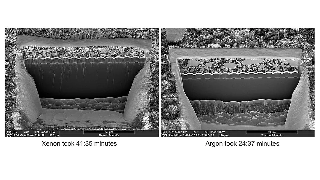

Xenon, for example, offers an alternative that addresses some of these limitations. With a higher atomic mass, xenon produces a much greater sputter yield than gallium, enabling it to remove material at a faster rate. This makes it particularly effective for coarse milling or when working on larger sample areas. Beyond speed, xenon is also regarded as one of the best for preparing transmission electron microscopy (TEM) lamellas, particularly when minimizing structural damage is a priority.
Argon is another option, given it is inert and relatively light. These properties allow it to minimize surface damage and avoid ion implantation. As a result, argon is well suited for preparing delicate, ultra-thin samples where maintaining the integrity of the atomic structure is essential. On the other hand, nitrogen plays a much more specialized role in FIB applications. In addition to its milling capabilities, nitrogen ions can chemically interact with target materials to form nitrides on the surface. This process can increase hardness, making it attractive when surface modification is as important as quality cross sectioning.

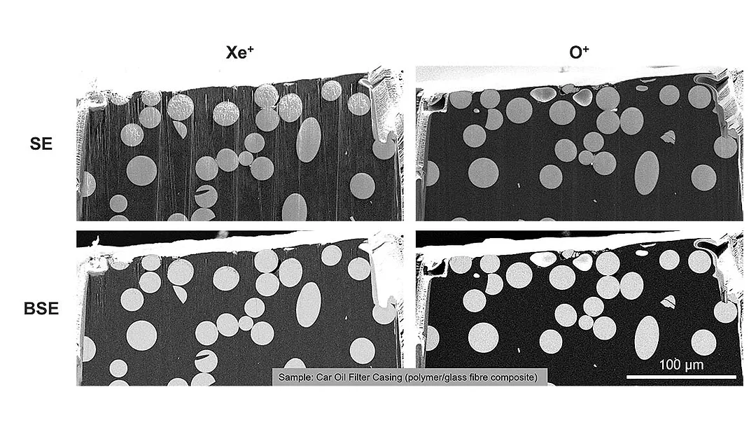

Oxygen, on the other hand, is particularly effective for soft, non-conductive materials such as polymers and tissues, which are difficult to mill cleanly at high rates. Oxygen PFIB produces smooth, curtain-free surfaces even in challenging samples. Where gallium and xenon can risk producing curtaining artifacts in these materials, oxygen ions create more uniform cuts that reveal fine structural details without heavy post-processing — making them the best choice for composites research, failure analysis and life sciences applications.

One illustrative case, carried out using Thermo Fisher Scientific equipment, comes from the study of a glass-fiber reinforced nylon 66 composite, a material widely used in automotive components such as oil filter casings. The composite contains about one-third glass fibers, each roughly 15 microns in diameter, embedded in a nylon matrix. This structure gives the material its stiffness and resistance to temperature extremes, chemicals and moisture, but also makes it challenging to prepare clean cross sections for analysis.
To examine the composite, researchers first used micro computed tomography (microCT) to locate regions of interest containing fibers and sparsely distributed defects. Guided by the reconstructed 3D data, they then employed a correlative workflow to target these regions for serial sectioning with focused ion beam milling. Both xenon and oxygen ions were tested under identical conditions. The comparison was striking: xenon milling produced noticeable curtaining, while oxygen PFIB created smooth, curtain-free surfaces that revealed fine microstructural details down to the nanometer scale.
The outcome underscored the importance of ion choice. While xenon remained usable at lower beam currents, oxygen plasma proved far more effective for this polymer-based composite, delivering cleaner sections and more reliable data. This example highlights how tailoring ion type to the material at hand can directly improve both cut-face quality and the efficiency of the overall analysis.
