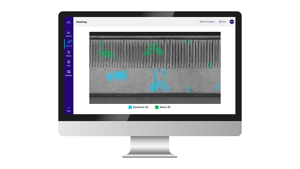

Key to leveraging all advantages of AI-powered quality control is the combination of quality data with production parameters in the cloud application. According to Droege, “Our AI inspection models run locally and do not require an internet connection. This is state-of-the art. But in addition, the data from quality control should be transferred to a cloud platform for further analysis, together with the process data. This data aggregation helps to identify possible correlations.” As a result, heat maps can be displayed, for example, in which the distribution of errors on manufactured components is visualized in real time. Views per machine and flexible filters by time period, shift, order, material, etc. provide further insights. These can reveal conclusions about the cause of the error, leading to improvements in the production process. This consistent digitization of the production process – from machine settings to the end product – enables a completely new understanding of processes and interrelationships. It helps reduce and prevent rejects over the long term.

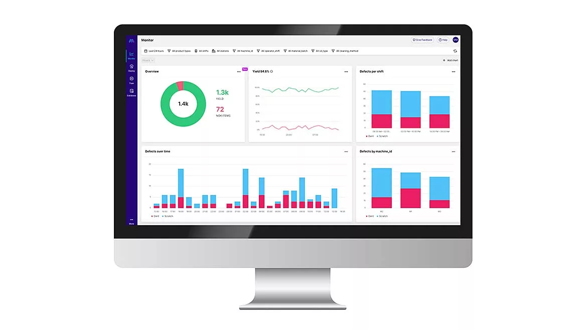

Combining and analyzing data enables conclusions to be drawn about the causes of errors. This helps to continuously improve production processes.

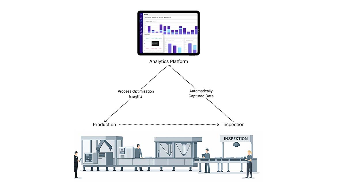

Production, quality, and process optimization in a closed loop
“The digitization of processes is increasingly becoming the norm,” says Droege. “With cloud-based and AI-powered platforms for data analysis, we enable data not only to be collected but also to be used profitably. We create a closed loop: from understanding production conditions via data, to product quality as a feedback signal, and back to optimizing production parameters. This creates a new understanding of production, and leads to less waste.” The more data the AI collects, the richer the understanding of production becomes, both for the AI and for engineers and operators applying these insights. Based on these insights, rules and measures can be derived for responding to production deviations during operation, in order to detect and avoid deviations even earlier in the future. To demonstrate secure cloud-based data transmission and processing to customers, solutions should ideally be SOC2 or ISO 27001-certified.
