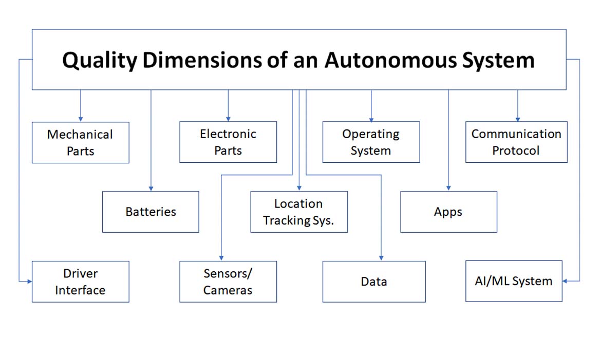

As to an autonomous system, many new dimensions were added, which need to be included in the overall quality of a system. The figure below shows a variety of key elements of an autonomous system.
This chart outlines the essential components and subsystems that define the quality of an autonomous system.
Figure 1. Quality Dimensions of an Autonomous System
Image Credit: Praveen Gupta
To develop a measure of overall quality of an autonomous system, one needs to first develop a method for determining the quality level of each dimension in DPPM (defective parts per million), then add all DPPMs to establish an overall quality of an autonomous system.
The following table shows an example of DPPMs for various elements of an autonomous system. The cumulative DPPM will highlight need to drive improvement and innovations for safer and user-friendly experience.

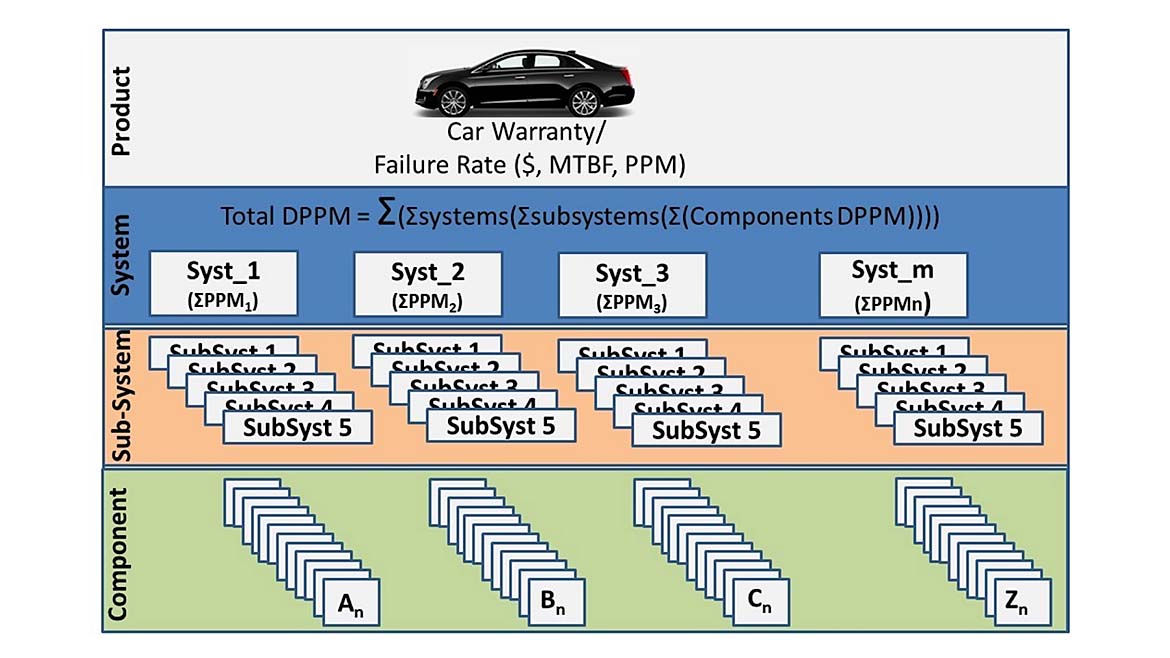

To improve quality, reliability, and integrity of an autonomous system, quality must be designed in instead of ensuring it through testing. An autonomous company may need multi-discipline design-quality engineers to ensure high quality of systems and sub-systems. As a first step, a set of quality goals must be determined for an autonomous system, then allocated to various subsystems and components.
Reliability and Quality Hierarchy commonly used in the automotive industry to calculate the overall failure rate of a finished product (a car)
Figure 3. Aggregation of quality of components, subsystems, and systems
