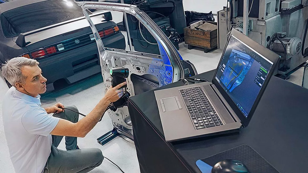

a person using a handheld Creaform 3D scanner to inspect a car door panel
Image Credit: FARO CREAFORM

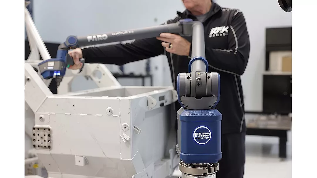

a FARO Quantum X FaroArm

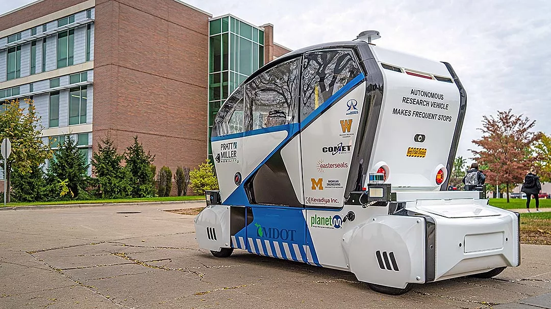

This image shows an autonomous shuttle bus developed for wheelchair accessibility at Western Michigan University.
