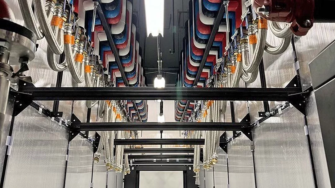

Data centers are evolving at an unprecedented pace, driven by the explosive growth of AI, cloud computing, and other high-performance applications. As demand accelerates, facilities are becoming larger, more complex, and requiring substantial investment to ensure 24/7 uptime, sophisticated power and cooling infrastructure, and advanced security systems. At the same time, market pressures, tight construction schedules, and a shortage of qualified workers are introducing risks that could compromise construction quality and operations.
For data centers, quality control cannot be treated as a single checkpoint— it must be embedded across the entire lifecycle of the facility, from early planning through post-occupancy. This requires coordination across five interconnected pillars of quality: design, manufacturing, installation, commissioning, and operations. When these five pillars are realized with equal focus and continuity, data center owners are more likely to experience long-term value—transforming their investment from a cost center into a durable, high-performing asset.
