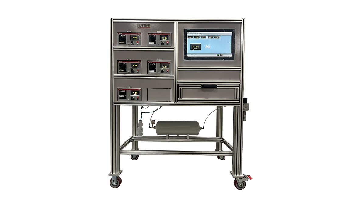

  1. Pressure Decay Testing
  2. One of the most widely used methods for evaluating cold plates, manifolds, and piping components.
    How it works:
    A component is pressurized with air, isolated, and monitored for pressure drop over time.
    Advantages:
    1. Nondestructive
    2. Suitable for medium to large volumes
    3. Easy to automate
    4. Well-suited for production environments
    Limitations:
    1. Sensitivity decreases with larger internal volumes
    2. Temperature changes can influence results
    a training or test unit
    Figure 2: ATEQ Cart Enclosure Repair Station with 5 F620 Leak Tester

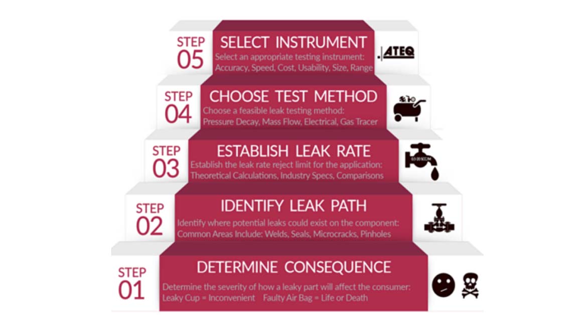

Best Practices for Leak Testing
  1. Determine Consequences. Assess how a leaking component would affect equipment or operations.
  2. Identify Leak Paths. Identify where potential leaks may exist on the manufactured component to design an efficient test process.
  3. Establish Leak Rate. Determine the reject limit through calculations and industry specifications.
  4. Choose Test Method. Select the appropriate method based on application and reject limit.
  5. Select a Leak-Testing Instrument. Choose an instrument based on required accuracy, speed, cost, and size.
