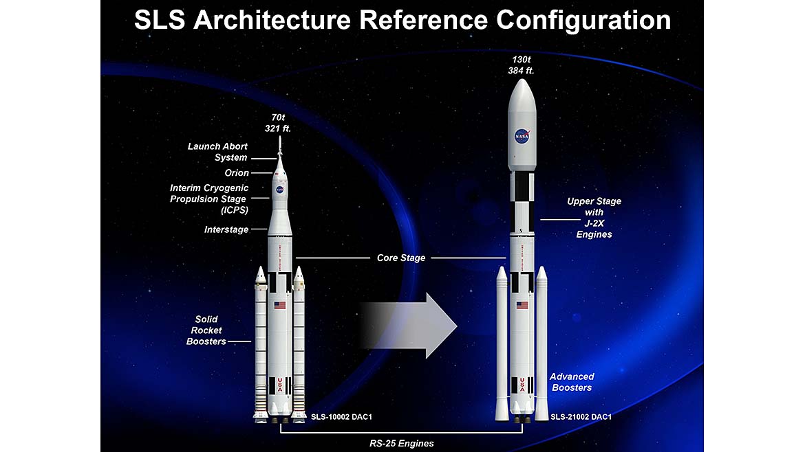

The core stage serves as the backbone of the rocket, supporting the weight of the payload, upper stage, and Orion spacecraft, as well as structurally supporting and carrying the thrust of its four RS-25 engines and two five-segment solid rocket boosters attached to the engine and intertank sections.
The core stage is the same diameter as the Space Shuttle external tank and is covered with an orange spray-on foam to insulate the cryogenic propellants. The stage is made up of 10 major barrel sections, four dome sections, and nine rings. Each cylindrical barrel section consists of eight aluminum panels that vary in length and height. Those components are welded to form five major components: the liquid hydrogen and liquid oxygen tanks, engine section, intertank, and forward skirt. Those five major components are joined to form the completed core stage.

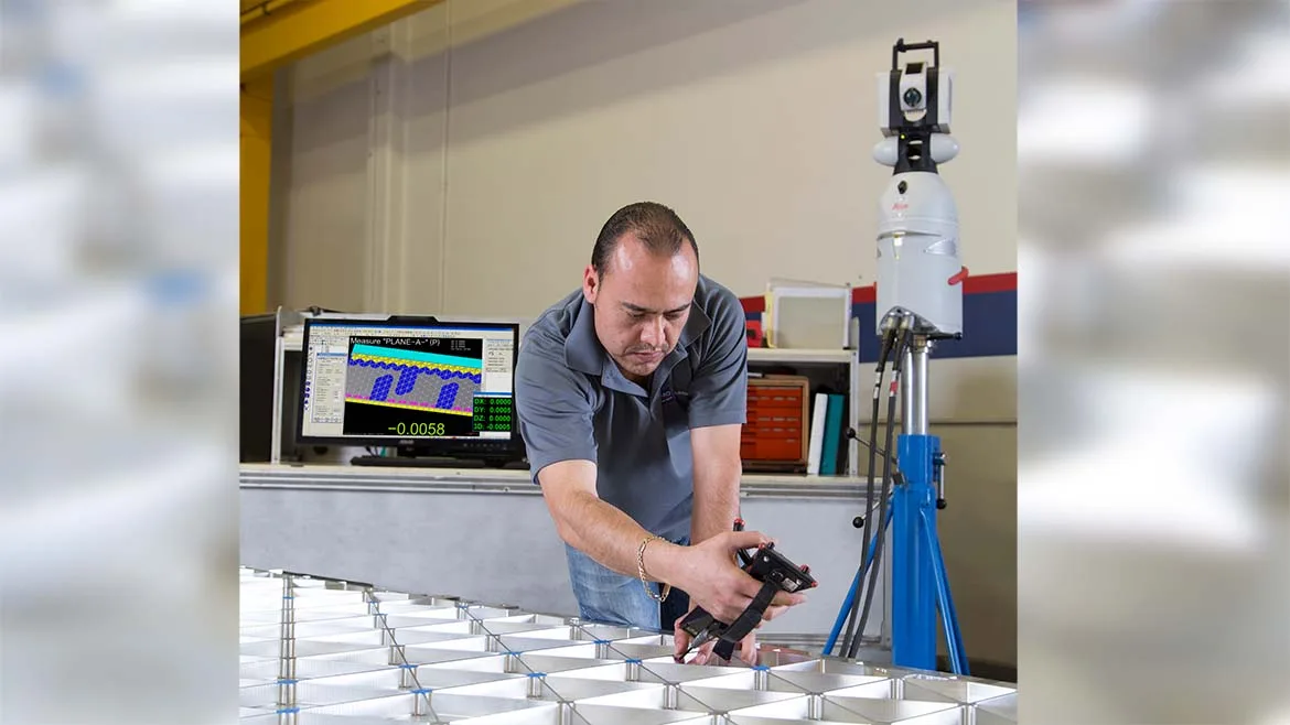

Each structural panel produced by Amro was a feat of modern manufacturing. Measuring approximately 12 feet by 24 feet, these panels began as solid aluminum plates and were transformed through a multi-stage process:
  • CNC Machining: Large volumes of material were removed to create the Isogrid/Orthogrid structure.
  • In-Process Inspection: Thickness, geometry, and features were verified during machining.
  • Flat Part Inspection: Laser trackers and probing systems confirmed dimensional accuracy.
  • Forming: Panels were carefully rolled into curved profiles.
  • Fixture Validation: Custom check fixtures ensured precise shape and fit.
  • Final Inspection: Comprehensive validation before assembly.
Each panel was inspected more than 20 times before completion. Eight panels formed a ring, and multiple rings were stacked to create the SLS core stage—massive cylindrical structures that ultimately enabled the Artemis II mission.
Model-Based Enterprise
While Amro provided the manufacturing expertise, Verisurf provided the digital infrastructure that made consistent precision possible.
Verisurf’s Model-Based Definition (MBD) approach allowed all inspection processes to be driven directly from 3D CAD models. This eliminated reliance on traditional drawings and ambiguity across the production process.
Key Contributions from Verisurf
  • Real-Time Inspection Feedback: Operators could see immediate visual confirmation of whether features were within tolerance, enabling rapid adjustments and reducing rework.
  • Inspection of Complex Geometries: Portable probing systems allowed technicians to measure hard-to-reach areas—such as behind grid walls—without repositioning equipment.
  • Digital Traceability: Automated AS9102 inspection reports provided complete documentation for every part, ensuring compliance and accountability.
  • Tooling and Fixture Development: Verisurf’s reverse engineering capabilities enabled the creation of precision check fixtures that matched complex panel geometries, ensuring accurate forming and assembly.
Together, these capabilities created a seamless digital thread, from design to inspection, that ensured every component met exact specifications.
