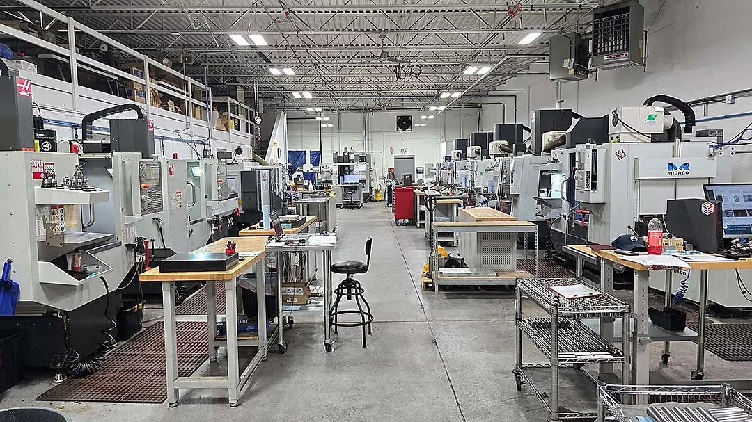

Grand Traverse Tool began in November 1995 as a high-precision mold and die shop. Over the years, the company expanded into general machining, eventually becoming a trusted supplier for industries that demand the highest quality and tightest tolerances. Today, the shop produces components for medical devices, energy systems (including those for gas and oil), aerospace and drone applications, maritime systems, and monitoring systems.

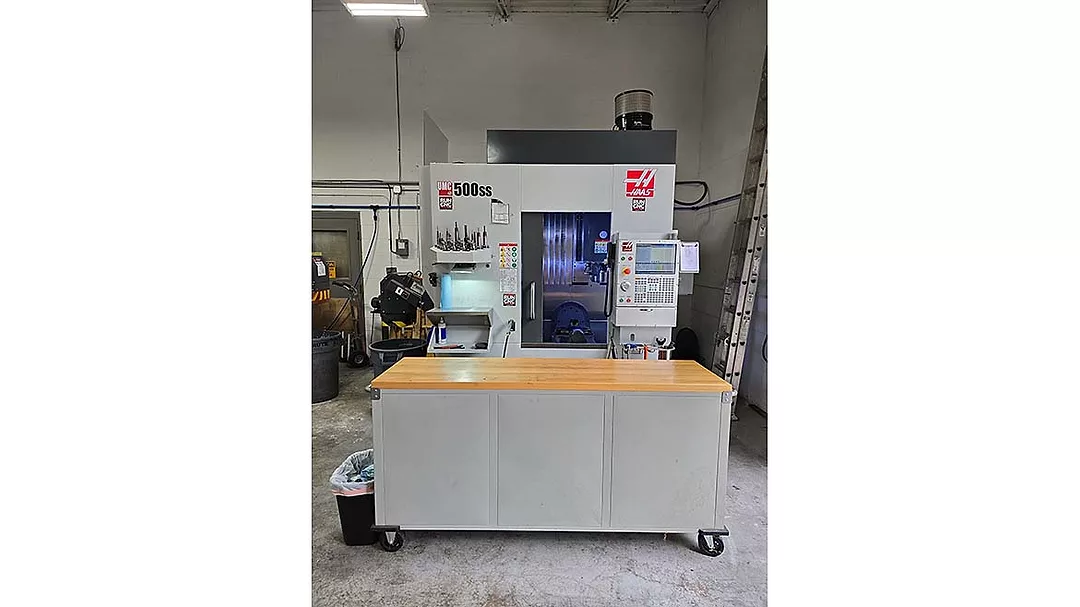

With just seven employees and ten Haas vertical mills, eight of which are equipped with on-machine probing, Grand Traverse Tool runs lean yet sophisticated. The shop uses Fusion 360 for CAD/CAM programming, supported by Haas probing systems for automated part and tool setup, monitoring tool wear and breakage, and verifying correct part loading on the CNC machines. New equipment, including a Haas 5-axis UMC VMC and a Tornos Swiss Lathe mill, is being installed to further expand capabilities.

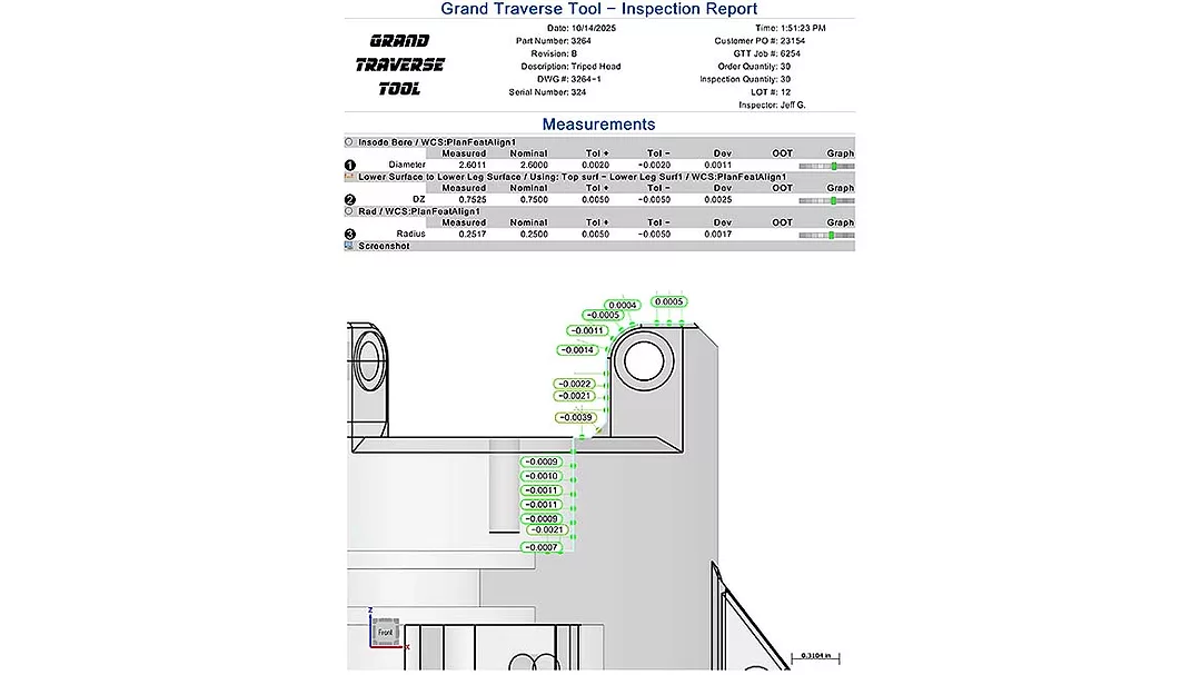

As Grand Traverse Tool has moved deeper into the medical, aerospace, and energy markets, quality verification requirements have become increasingly demanding. Many parts now require complete Production Part Approval Process (PPAP) documentation. For example, every new medical part requires inspection of the first 30 pieces, followed by three pieces per thousand during production, as well as critical tolerance checks on nearly 5% of all output.

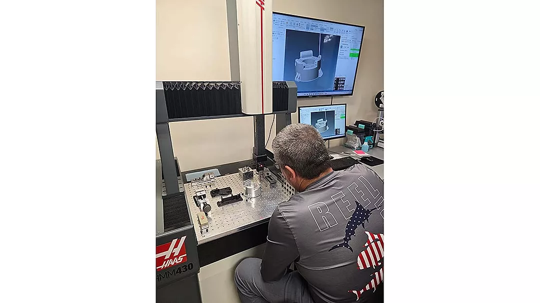

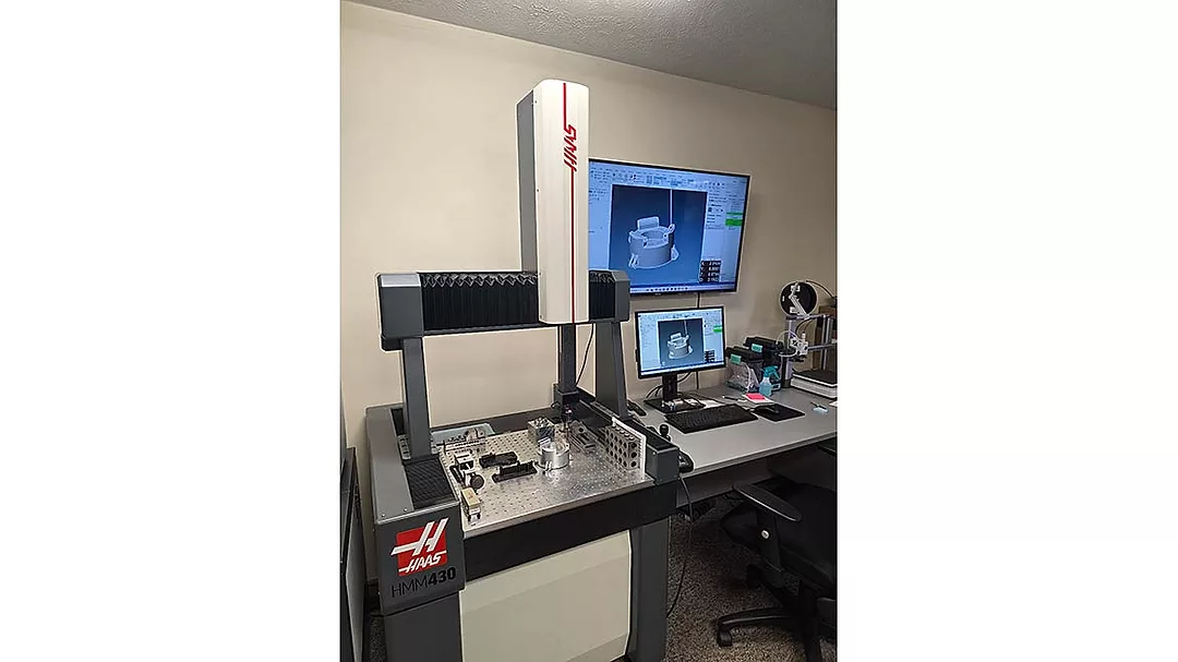

Haas sent three technicians to Traverse City to install the very first Haas CMM sold worldwide. While the machine itself met expectations, the software presented an immediate challenge. The OEM software relied heavily on G-code editing and lacked seamless integration with CAD models. For a shop that lives in the world of model-based manufacturing, this was a significant limitation.
“We loved everything about the CMM, but not the software,” Gothrup admitted. “We needed something that could relate measurement data directly back to the 3D CAD model. That’s when we were introduced to Verisurf.”
Through a connection in southern Michigan, Gothrup discovered Verisurf, a powerful model-based metrology platform. After testing it, he quickly realized it was the missing piece. “I liked Verisurf CMM Manager immediately. Verisurf delivered on everything we needed to maximize the value of our Haas CMM – we use it every day.”
Verisurf in Action

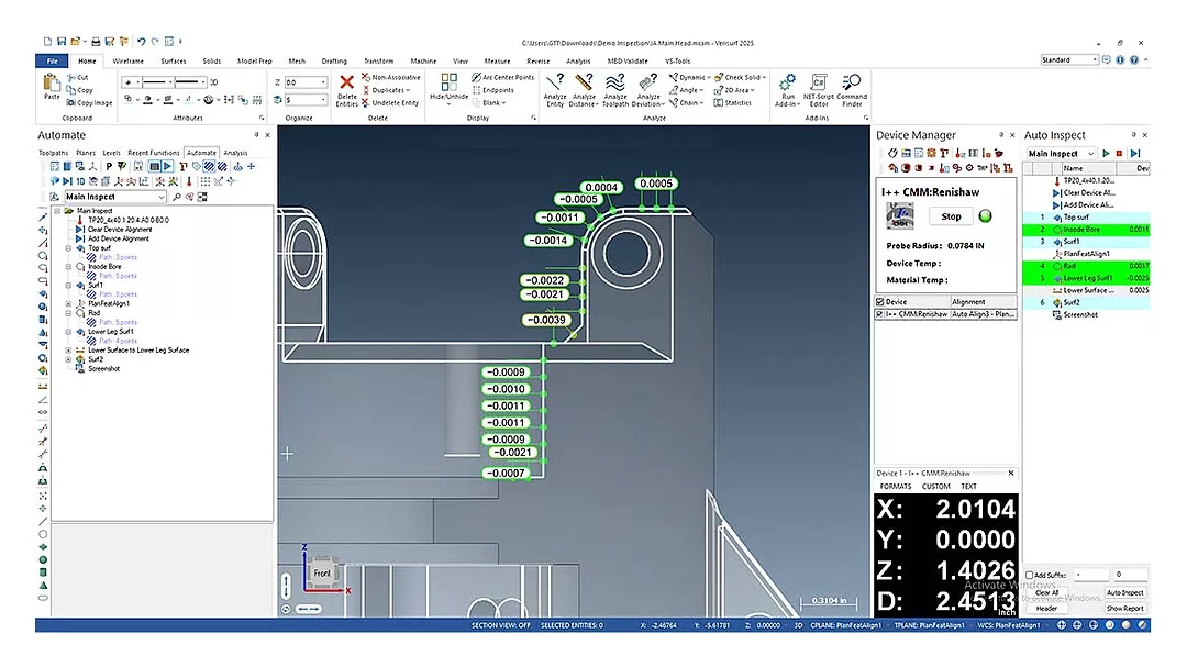

By pairing the Haas CMM with Verisurf software, Grand Traverse Tool gained a complete model-based inspection solution. Verisurf enables machinists to import a 3D CAD model as the “virtual golden part” and then automatically drive the CMM to align and measure the physical part.

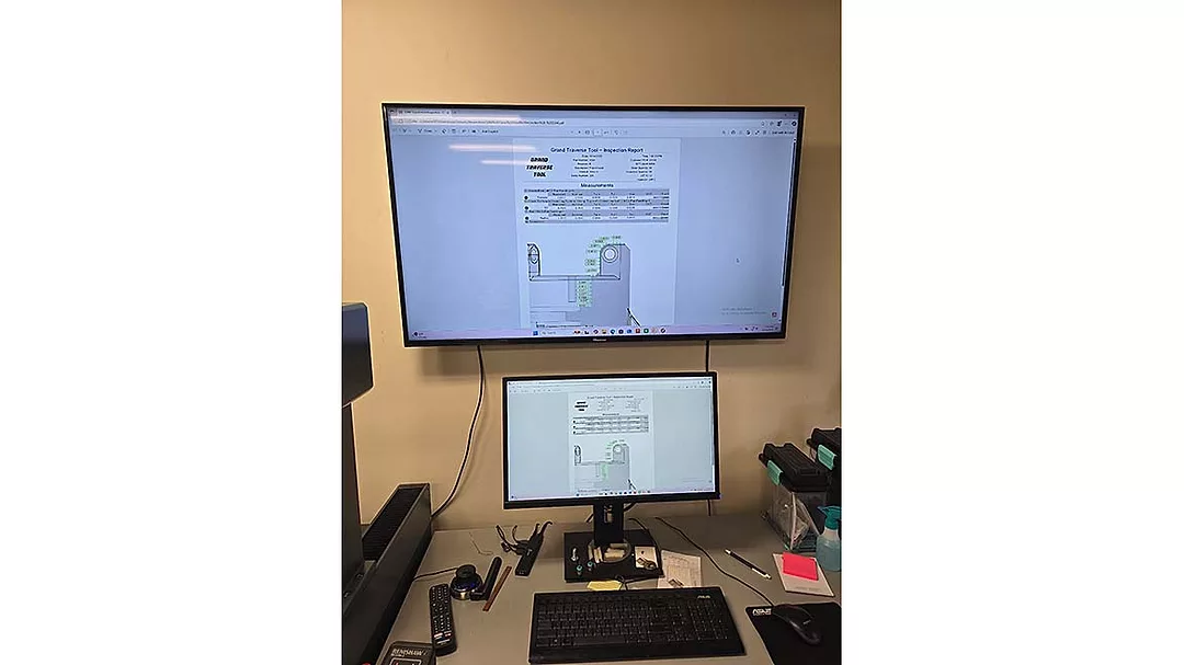

For recurring jobs, Grand Traverse Tool takes the process even further. The team designs and 3D prints custom fixtures for each family of parts. When a new run begins, the operator loads the first finished part into its dedicated fixture, places it on the CMM, calls up the inspection plan in Verisurf, hits “play,” and lets the software handle alignment, probing, and reporting.
The impact on production efficiency has been significant. Machinists now cut the first part of a run, bring it to the CMM, and within minutes have any deviations from nominal tied directly to the CAD model. Any out-of-spec conditions are flagged immediately, allowing the machinist to make necessary adjustments. Typically, by the first or second part, the run is dialed in and stable. Finished part inspection and reporting is then completed as required by customer specifications.
“Verisurf provides a direct feedback loop between inspection and machining,” Gothrup explained. “It allows our machinists to set up and validate parts quickly and accurately, which saves time and reduces scrap. Verisurf software has made our Haas CMM a true asset.”
