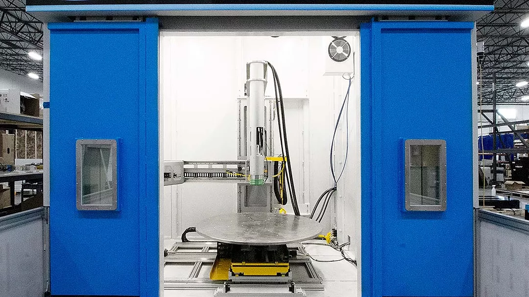

This is an industrial X-ray computed tomography (CT) system, likely a Pinnacle X-ray PXS-VDM model.
Source: Comet Technologies USA Inc.

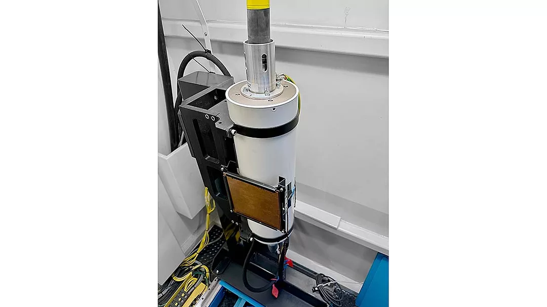

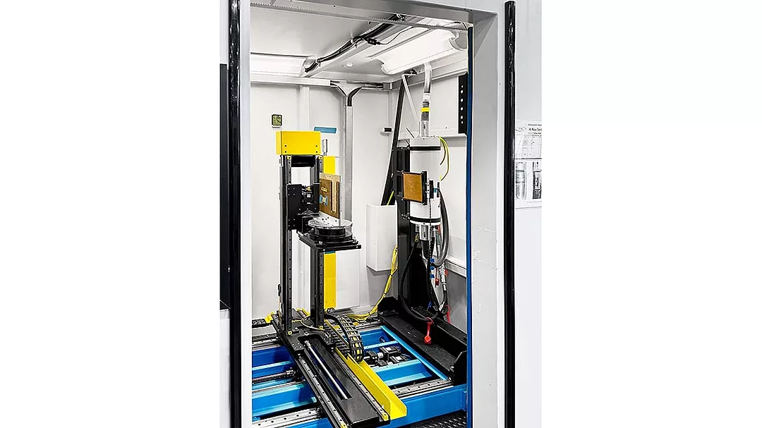

an industrial X-ray or CT scanning system designed for automated inspection and assembly.

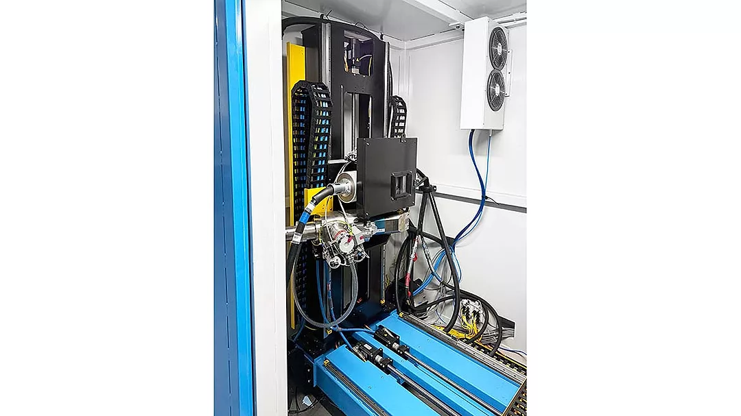

This is an industrial high pressure waterjet system, likely used for stripping or cleaning critical surfaces.
