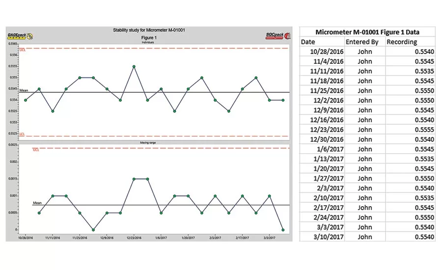

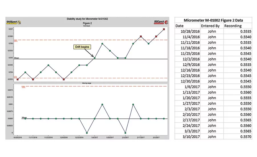

John is a technician at his company and he has been tasked with performing stability studies on two similar gages to determine whether the calibration intervals are set appropriately. Gage M-01001 is assigned to the inspection lab, while M-01002 is used on the shop floor. Both micrometers were calibrated at the end of October in 2016. John began the studies on October 28, 2016, and continued to record new measurements each Friday.
Figure 1 and Figure 2 show the recorded data for both studies. John took the measurements at same time of day each Friday and in the location where the gage resided to avoid environmental influences.
Reviewing the data can be helpful, but the real benefit is from seeing control charts that are generated by this data, where changes and drifts can be spotted more easily.
In M-01001’s chart, while there is variation between measurements, the gage is fairly stable. It currently has a six-month calibration interval, so as of now there is no evidence to suggest that the calibration should be completed before April 26, 2017.
In contrast, the chart for M-01002 shows a noticeable drift in the measurements near the beginning of January. Something has altered the gage’s ability to maintain stable and consistent measurements. An early calibration is warranted in order to bring the gage back into proper working order and accurate measurement.
Waiting until April 2017 to calibrate M-01002 may have resulted in numerous parts being rechecked to validate the measurements, thereby wasting time, resources, and energy for the quality department. Further stability studies on this gage could provide the evidence needed to reduce the calibration interval to three months so potential issues are caught before the gage begins to wear or drift out of tolerance.
