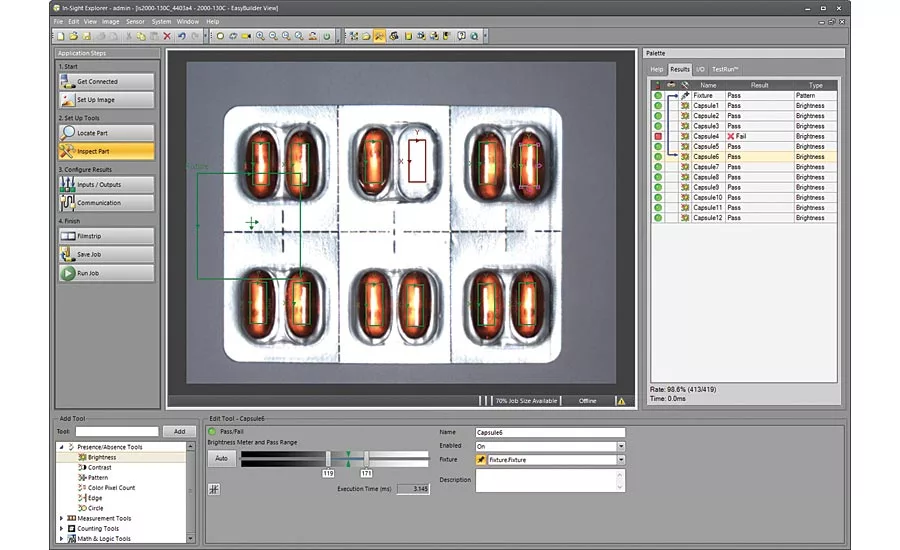

Figure 1: Vision sensors use an intuitive interface for setup.

Vision sensors offer the ability to perform these and many other inspections at a lower cost and with a much simpler setup than conventional vision systems. A typical vision sensor includes a complete image formation system with lenses and lighting. Some vision sensors allow the lens and light to be swapped out if necessary to meet the requirements of specific applications. Most vision sensors feature an intuitive point-and-click user interface for setting up the device. For example, a customer can inspect for the presence or absence of a part or feature simply by focusing the sensor on the object to be inspected and drawing a box around the feature of interest. Some vision sensors are also capable of more complex inspection operations such as measuring distances, angles and circle diameters.
