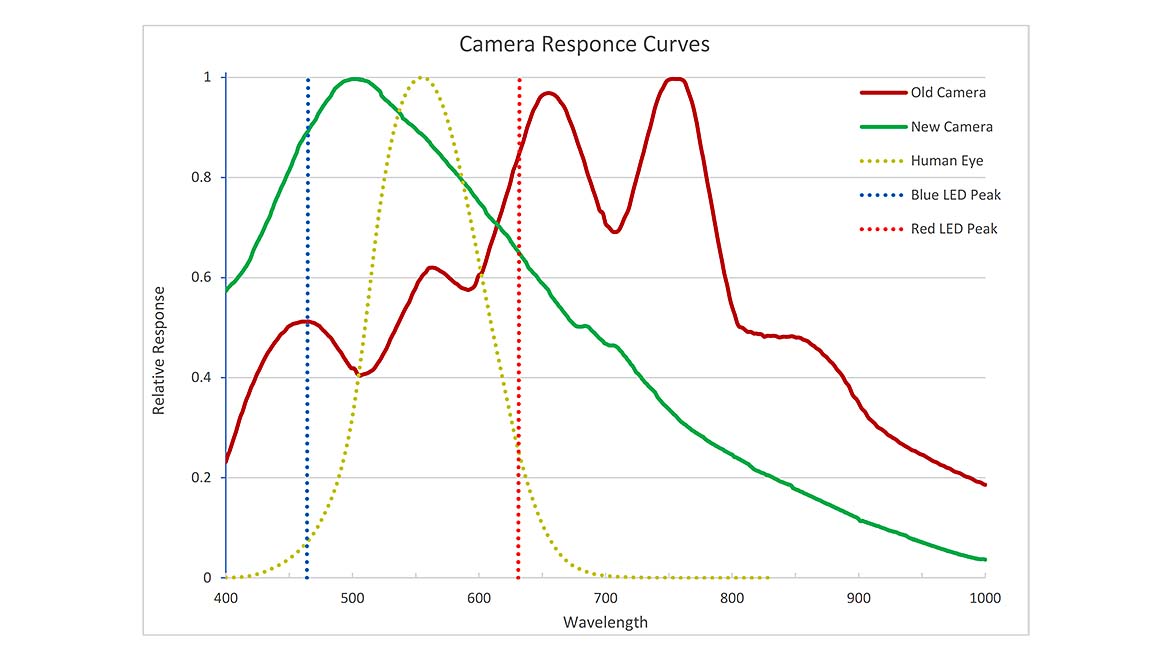

What started to emerge should have moved a good percentage of monochrome applications over to blue high-output LEDs. The newer vision camera systems have imaging chips with the highest spectral response in the cyan (505nm) range (see Chart 1). I know that cyan isn’t blue but that will be explained later. The problem has been that LED manufacturers have been specifying the output of their LEDs in luminous flux (lumens). The following is taken from wikipedia.org and defines the terms currently used to measure LED output.

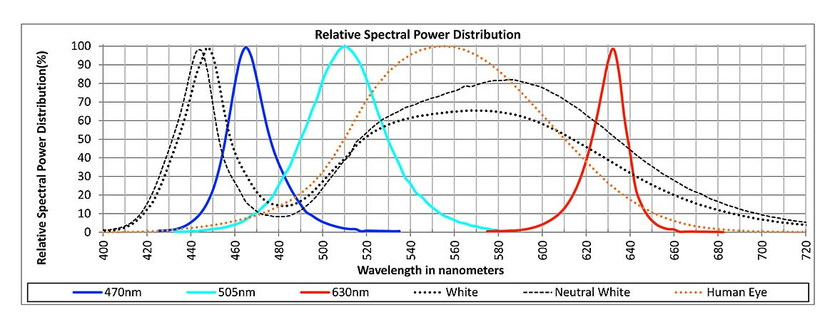

Vision lighting vendors should adopt the radiant flux (watt) or a milliwatt unit of measure so that a uniform standard can be used for light output comparison. The milliwatt standard would be based solely on the power output of the LED and because LEDs have a narrow spectral output a customer could apply that information directly to a camera’s spectral response curve (see Chart 1). This brings me to the point that I made earlier, most of the newer vision systems produced have imaging chips with the highest spectral response in the cyan (505nm) range. You would think cyan would be the best choice but because blue LEDs have 2.4 times more mW output than cyan LEDs it is not (see Table 1). The point is that the LED manufacturers are not making many improvements in cyan LEDs but they are making gigantic strides in blue (470nm) LEDs due to the race for higher-output white LEDs. You will notice in Chart 2 that the spectral response curve of either the white or neutral white LED is highest in the 450nm blue range because of how they are manufactured.

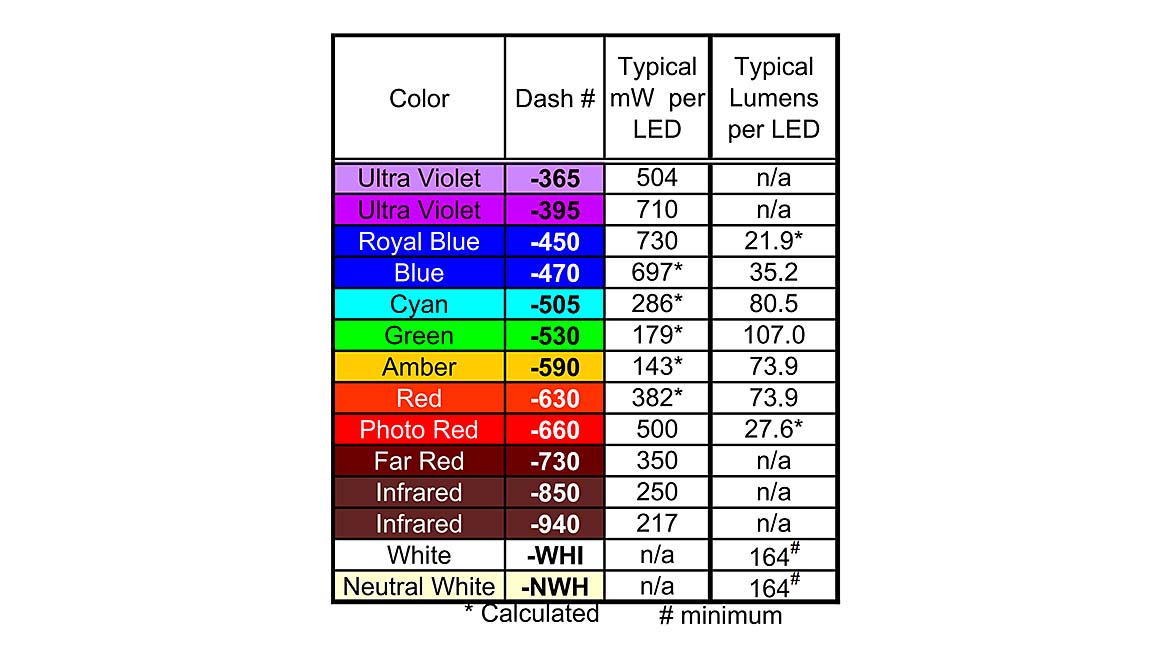

If you follow Table 1 above you will notice that the typical output of a blue LED is only 35 lumens and the red LED is 74 lumens but these values are based on the human eye spectral response. Because the lumen output of LEDs is the norm for light output and because milliwatt output is harder to calculate most vision lighting companies don’t feel they need to change. When you look at the actual milliwatt output you notice in Table 1 that the blue LED has 1.8 times higher mW output than the red LED. Based on this information and the fact that most of the imaging chips in newer monochrome vision cameras have a higher spectral response in the blue range, you would agree that blue (470nm) would be the best choice.
