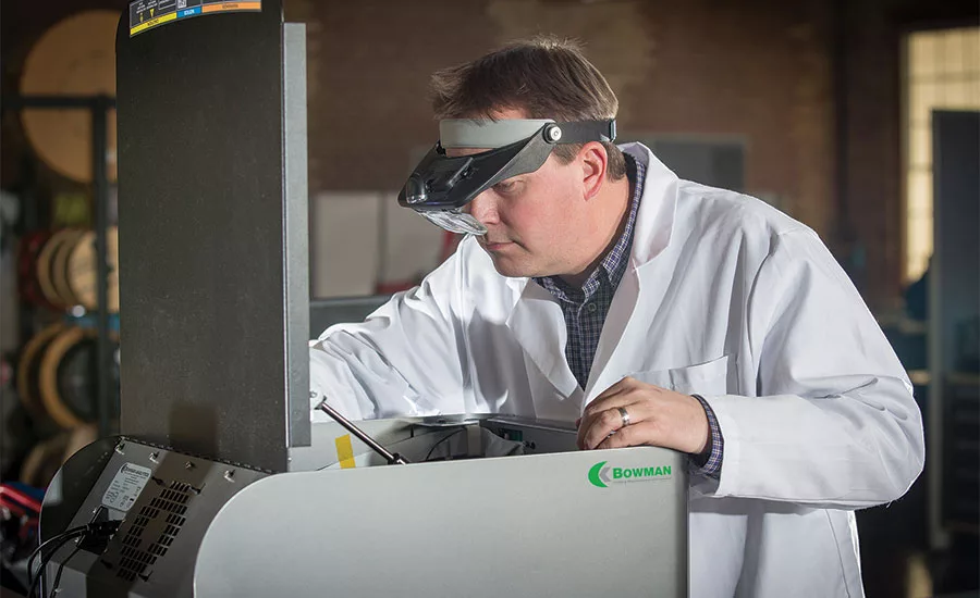

XRF coating thickness measurement
XRF coating thickness measurement instrument with silicon drift detector. Periodic inspection of the measurement head is one of the few maintenance tasks needed for this system. Source: Bowman
