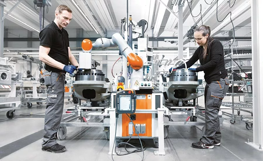

Originally made popular by the introduction of Rethink Robotics’ Baxter, so-called collaborative robots have created a lot of excitement around the industry over the last few years. Before that, robots had been seen as limited to large industrial projects where they sat behind safety fences without human interaction. Recent advances in technology, however, have brought humans and robots closer together in a variety of industries and created a high demand in the marketplace.
Just how much demand is difficult to gauge because of the way that the data is collected. All established robot manufacturers make what they call “collaborative” robots, but a large percentage of those sold are used in non-collaborative environments without humans. Conversely, many large industrial robots are operated in collaborative environments with the aid of an area scanner or light curtain. Reporting agencies, however, only count those advertised with the distinction in the collaborative category.
What is not in question is that these robots have opened up a number of exciting uses. But in some cases, their industrial counterpart can perform the same actions at a higher level. So, how do manufacturers find out which solution is the right fit for their application?
Why collaboration is hot
Collaboration offers adoptees a lot of potential benefits. These robots can assist workers with ergonomically challenging tasks and support a lot of non-standard and small volume applications. Many of them can be inexpensive and easy to set up. “Cobots,” as they are sometimes referred to, can be quickly redeployed in other production environments doing the same job or different jobs, providing much needed flexibility.
Since these robots do not need to be surrounded by a fence to operate, manufacturers can better utilize their floor space, sometimes saving as much as 50% in total area with the same application. This relief is especially helpful in facilities that do not have room for expansion.
Because they have round edges, low payloads and operate at low speeds, many of these “cobots” are safer coming out of the box than their industrial counterparts. But it’s important to remember that their tooling and payload can bring up important safety considerations, especially if they are sharp or hot. All of these robots still need to have their safety parameters configured and, depending on the application, may require extra hardware, like area scanners or vision, to make them safe.

With the right safety technology, industrial robots can operate in a collaborative environment.

Hand guiding is often what people picture when they hear collaborative robot. While these applications are a great developmental tool, they are not very useful in production. Most robots used in power and force limiting applications are described as “collaborative” by their manufacturers. There are very useful, but have to be slowed substantially to work alongside a human without an area scanner. Speed and separation monitoring and safety-rated monitored stop allow both collaborative and industrial robots to work safely around humans by either slowing or stopping when a worker gets near.
‘collaborative’ robots
One of the benefits of ‘collaborative’ robots is their ability to assist with ergonomically challenging tasks.
There is a wide spectrum of collaboration with a robot, including a fully separated workspace, or separation without a physical barrier. You can occasionally share a workspace, or separate the robot and person while they are working in the same space. The ultimate collaboration is when the robot is working with people all the time. That is where the unique features of a collaborative robot improve safety, but there is a wide variation in optional features so looking for the lowest cost option is rarely the best choice.
A ‘collaborative’ robot
A ‘collaborative’ robot can add much needed flexibility by moving from machine to machine.
