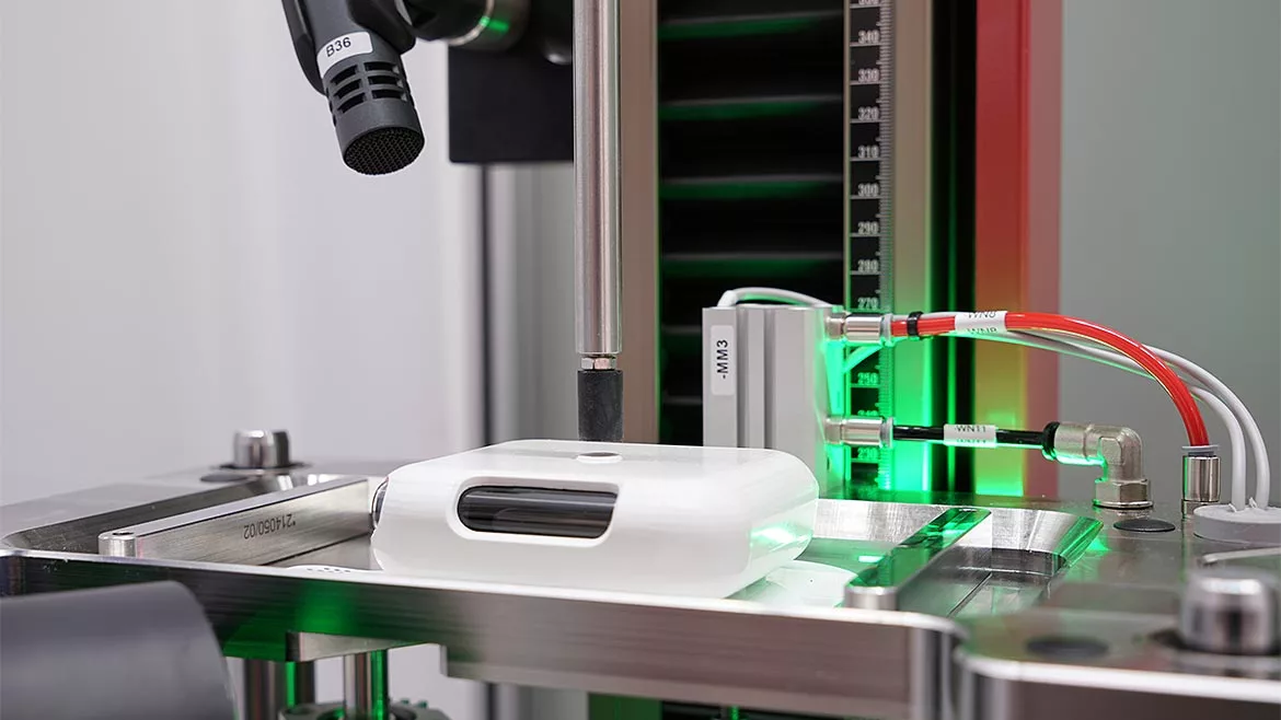

Medical feature image of ZwickRoell OBDS testing setup.
ZwickRoell OBDS testing setup. All Images Source: Zwick Roell

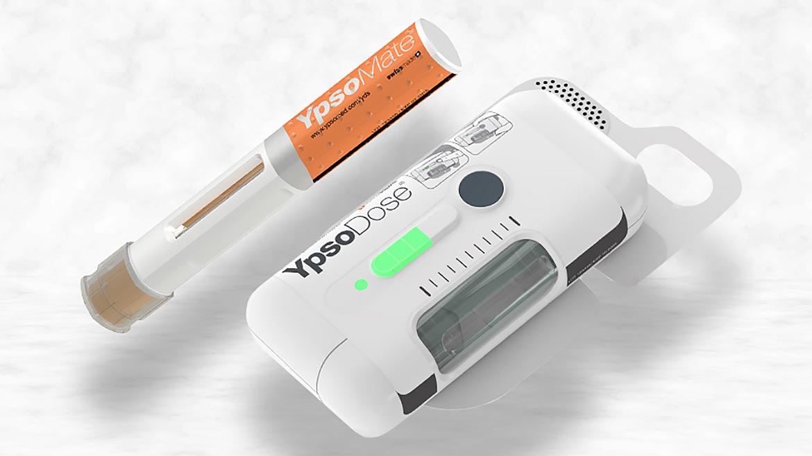

Medical: YpsoMate – The 2-step autoinjector and YpsoDose – Pre-assembled patch injector
The evolution from autoinjector to OBDS requires new testing solutions for buzzer sounds, LEDs, motor drives, expanded injection times (seconds to minutes), adhesion, and more.
