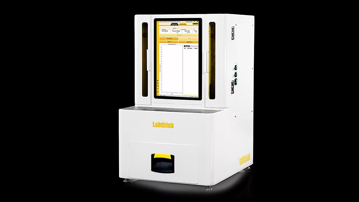

Labthink’s brand new automated vial batch leak tester.
Labthink’s brand new automated vial batch leak tester. Leaking vials are automatically segregated for further inspection. Image courtesy of LabThink
