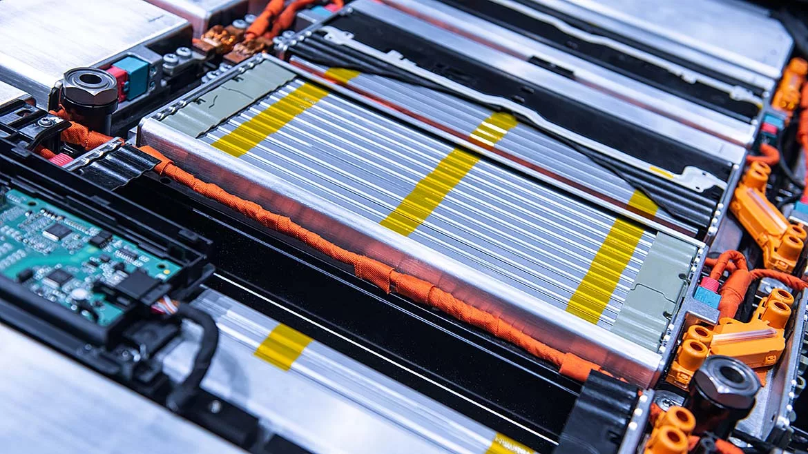

Electric car lithium battery pack. Blue toned. Car maintenance.
Electrification is advancing: in addition to electric and portable consumer electronic devices, batteries are also increasingly finding their way into electric vehicles and home storage systems. Copyright: Shutterstock, 1297860037
