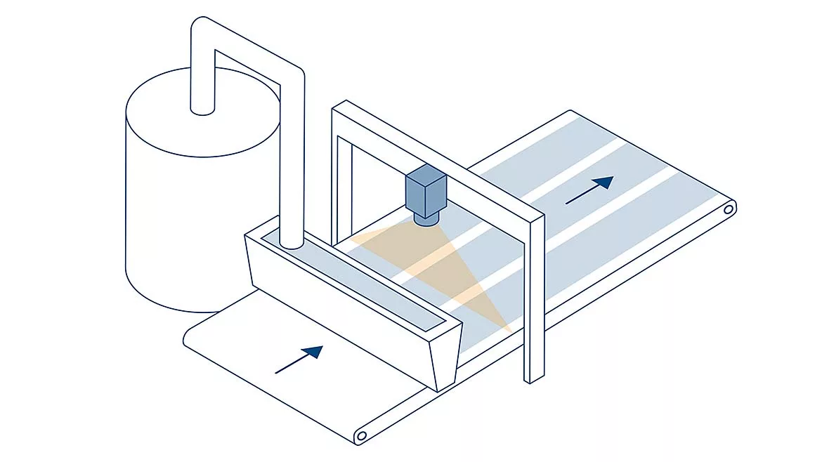

Coating the substrate foil with slurry is a critical production step. The surface quality must be uniform, free of voids and particles, and the thickness of the slurry must be precise and homogeneous.
Electrode coating in detail
In electrode coating, the carrier or substrate foil is coated with the previously mixed slurry using an application tool such as a slot die, doctor blade, or anilox roller. The top and bottom sides of the foil can be coated in parallel or sequentially. This is followed by a drying process.
This process step is particularly critical because many parameters must be precisely coordinated: the slurry must have the required stability and be applied at the correct rate. The aim is to achieve perfect coating homogeneity, without cracks or agglomerates, as the electrode layer is particularly important for battery performance.
However, many defects can occur in both intermittent and continuous electrode coating. Typical defects include agglomerates, coating cracks, contamination from foreign bodies and micro-compressions that occur when the coating is applied too thinly. Mud cracks, pinholes and breakouts at the end of the coating web are also possible defects.

Image processing during production presents a dual challenge. Very high production speeds generate large amounts of image data. At the same time, a high level of detail is required (which is achieved through high image resolution), generating even larger amounts of data. Conventional solutions generally do not have the processing power required to maintain the required production speeds.
Advanced image processing technology on the other hand ensures reliable quality control during electrode coating. Highly sensitive line scan cameras are suitable for continuous material and deliver the necessary throughput and the required image quality. But with the use of targeted image pre-processing, only a fraction of the data volume needs to be analyzed. A combination of software and a frame grabber pre-processes the image data and thus creates the necessary focusing for the actual image processing. By determining the ROI (region of interest), only the areas with irregularities are localized first. Only the image data of the ROI is then viewed and further processed.
This has the advantage that the CPU of the IPC can continue to be used for the actual system control without any additional load. In the next step, the irregularities within the ROIs can be further analyzed. Specialized software for image analysis can, for example, classify the type of defect or measure the size of the defect. Depending on the type and size of the defect, a decision is made as to whether it is within the tolerances or whether further measures are required. Defective areas can be precisely cut out thanks to exact localization and measurement. This improves the quality of the battery cell and minimizes material waste.
