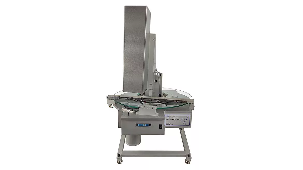

Orion194 Flat Platen Sorter
Image Source: Six Sigma Concepts
As tremendous as this capability is, there are inherent limitations when it comes to performing geometric dimensioning and tolerancing measurements. Backlit systems can only look at the outermost points of the profile. They cannot find reference features or defects that are obscured within the outer profile. This does not tend to be an issue when measuring runout between outside diameters, but unless the part is fixtured to an interior feature, measurements cannot reference that feature. Likewise, when measuring flatness, slope, convex, and other outward facing defects can be detected. But concave defects, like depressions, dents, and grooves are obscured by the surrounding material.
Tools tailored to continually rotating parts can be used to find features that are only present at set facings. This allows systems to measure cross holes and cross hole positions, as well as flat widths and cross corners on the fly. Additional functionality can be gained by setting conditions on when tools operate. With the proper conditions set, features that only appear at particular facings can be measured during continuous rotation. For example, a chamfer tool can be set to operate only when the corner profile of a hex is facing the camera.
Rapid image acquisition and high precision are key components to 100% inspection. There are a myriad of methods to automate part presentation to backlit video metrology systems, robots, belts, metal and glass rails, as well as metal and glass disks are the most predominant methods. Glass is often favored, as it allows images to be taken through it. High volume rates can generally only be achieved when parts continually move through a system from feed to inspection to sorting. Continual movement provides additional challenges, such as motion blur, consistent part facing, and critical operation timings. Overcoming these limitations allows for a single system to inspect and sort hundreds of thousands of parts within a single day.
