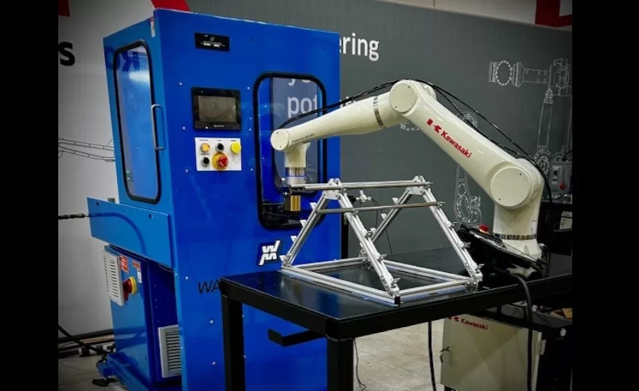

Kawasaki Robotics is demonstrating the full family of CL Series cobots in a cooperative motion display at IMTS 2024 while a CL110 cobot will machine tend an upgraded Wauseon Machine 1004EL Electric End Forming Machine and an interactive display featuring a CL108 cobot will allow users to experience the CL Series Zero-G mode by hand guiding and recording programs using the lightest touch. Saved parameters improve setup consistency and reduce setup errors.
