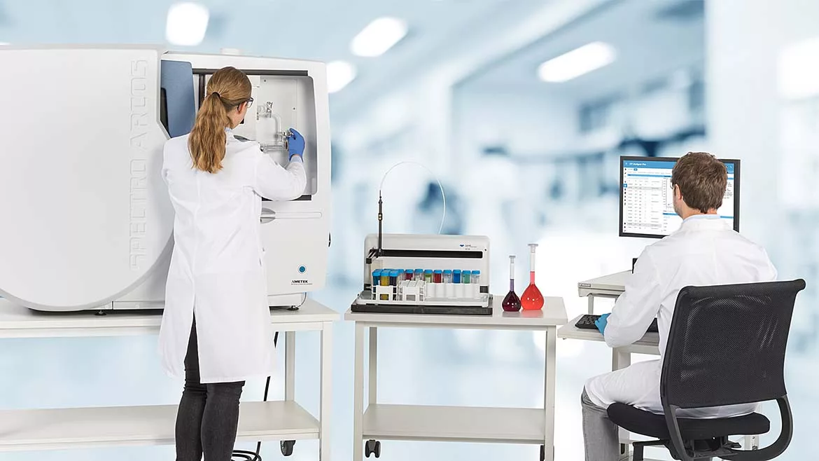

SPECTRO ARCOS for the ICP-OES section
Image Source: SPECTRO

2. Inductively Coupled Plasma Optical Emission Spectrometry (ICP-OES)
Another analytical technique for compositional analysis is ICP-OES, especially when high sensitivity is a major requirement. It relies on exciting atoms in a sample by means of high-temperature plasma, which will then emit light at a characteristic wavelength after being excited. The resulting intensity from the light emitted by these atoms is measured to quantify the concentration of elements within the sample.
ICP-OES works very well for dissolved samples; hence, this technique is suitable for testing the materials that can be dissolved into a liquid form. It does give very great sensitivity, where it can detect elements in levels below ppm and can handle a wide range of elements across the periodic table. On the other hand, ICP-OES is a destructive technique because the sample has to be dissolved to analyze it, and there is a probability of error during the preparation of the sample.
Within the context of additive manufacturing, ICP-OES finds broad applications in the analysis of metallic powders for elemental composition and trace impurities, which could influence the quality of the final products. Another good application of this technique is the verification of powder composition to ensure the specification requirement by blending powders.
