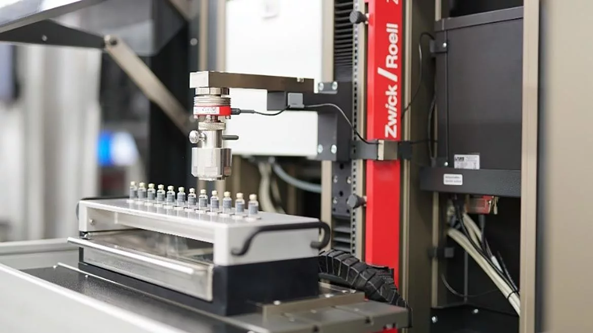

Vial testing
ZwickRoell zwickiLine for automated leak tests of vials. Image Source: ZwickRoell
