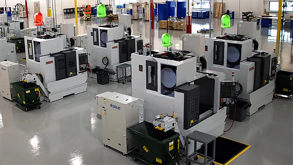

Machine shop floor.
Image Source: Prolink Software
