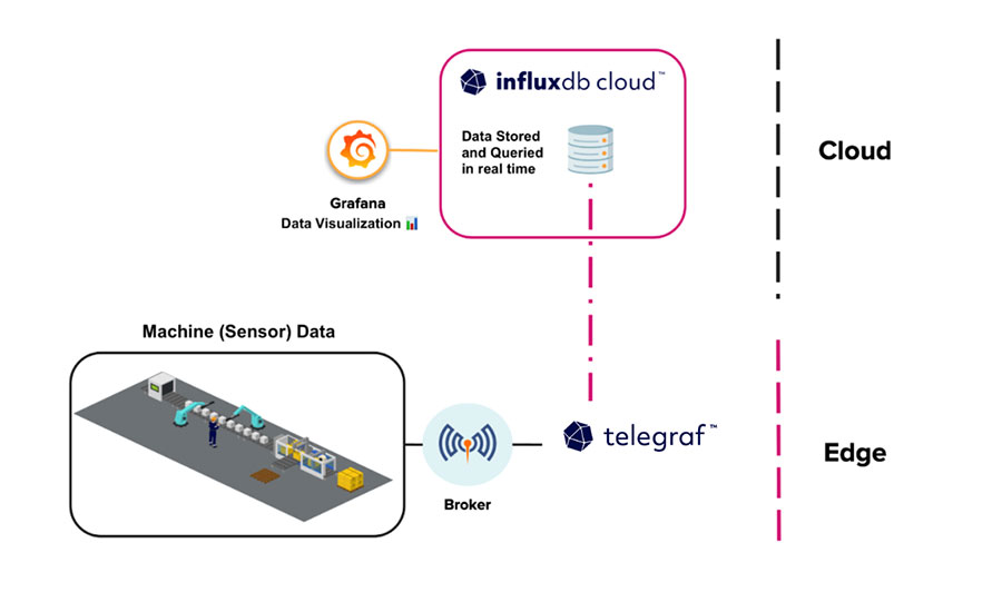

typical journey of data in real-time, from sensor to actionable insight
A comprehensive data pipeline is essential to unlock the full potential of machine data. This diagram illustrates the typical journey of data in real-time, from sensor to actionable insight, showing each step and the technology involved. Illustration courtesy InfluxData Inc.

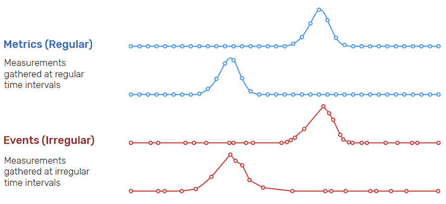

temperature data measurements by metric vs. event
A time series database efficiently handles large volumes of time-stamped data from sensors and machines. Unlike traditional databases, it’s optimized for high-volume data streams, enabling real-time monitoring of metrics (measurements gathered at regular time intervals) and events (measurements gathered at irregular time intervals). Illustration courtesy InfluxData Inc.

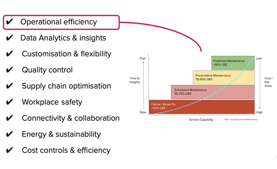

With real-time processing and machine learning, InfluxDB is crucial for predictive maintenance in Industrial IoT. Unlike scheduled maintenance, which often results in unnecessary servicing, or the costly “fix-when-broke” method, intelligent predictive maintenance enables proactive intervention, forecasting issues before they occur and optimizing maintenance schedules.
Ultimately, predictive maintenance is less costly and more efficient than scheduled maintenance or worse, waiting until a machine breaks down. Illustration courtesy InfluxData Inc.

A comprehensive data pipeline is essential to unlock the full potential of machine data. To get a sense of that, it’s useful to outline a typical data journey in real-time, from sensor to actionable insight, highlighting each step and the technology involved.
The first step is collecting data from machines. Sensors on machinery collect critical metrics, such as temperature, vibration and speed. Using brokers, protocols like MQTT, Modbus and OPC-UA gather this data, integrating with tools like Telegraf to send data to InfluxDB. For larger-scale operations, software like Kafka can handle data streaming, while Node-RED offers simple, visual data flow programming.
For some manufacturers, the next step might be local storage of that data. For manufacturers with limited or intermittent cloud access, InfluxDB’s open source version allows local data storage on-site. This setup maintains data access continuity and adds redundancy, ensuring no data is lost if network connectivity to the cloud is interrupted.
Other manufacturers might choose to keep their data in centralized cloud storage. InfluxDB Cloud offers high-speed ingestion and scalable storage, consolidating real-time and historical data into a single platform. Its edge data replication capability adds an extra layer of data protection, so manufacturers have uninterrupted access to data, even during network disruptions.
Once data has been collected, the next step is real-time visualization and alerting. Tools like Grafana and Power BI enable manufacturers to visualize and analyze their data through custom dashboards. Operators can continuously monitor key metrics like machine vibration levels or temperature thresholds to quickly assess equipment health.
Automated alerts can be configured to notify plant managers and IT staff via SMS, Slack or email if certain thresholds are met. For example, a rise in machine vibration beyond safe limits could trigger an alert to initiate an inspection, preventing unplanned breakdowns.
Finally, manufacturers can apply advanced analytics and predictive maintenance with machine learning. InfluxDB’s time series data can feed into advanced analytics models for deeper insights and predictions. Using platforms like TensorFlow or EdgeML, manufacturers can analyze the root causes of equipment failure and uncover optimization opportunities that further reduce costs and downtime.
