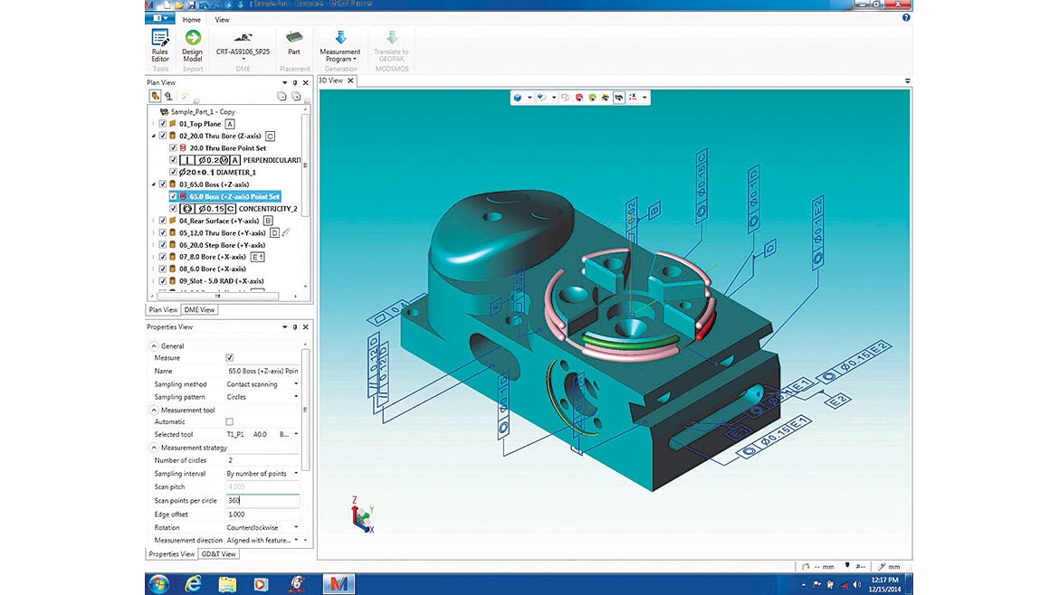

MiCAT Contact Scanning Boss
By comparing measured data against a digital CAD model like in the image, manufacturers can detect deviations in real time and adjust production processes accordingly. Digital twin technology can continuously update the virtual model based on physical measurement feedback. Image Source: Mitutoyo
