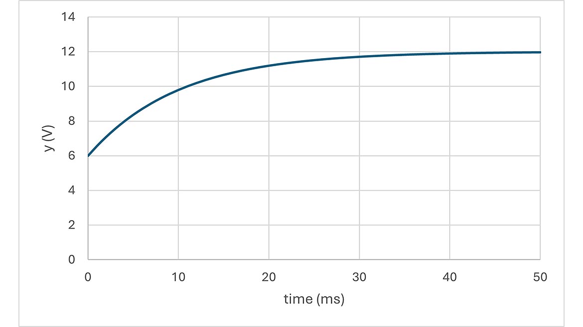

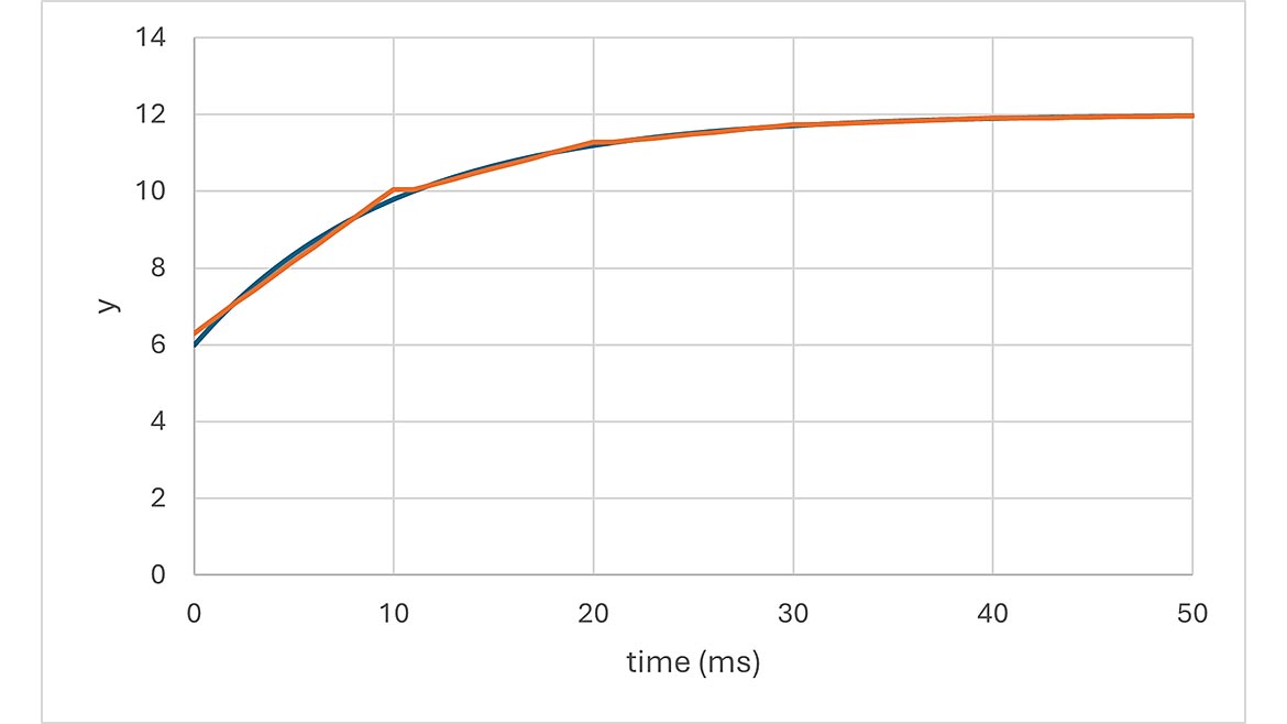

Consider an RC circuit with a 10 kΩ resistor and a 1 µF capacitor. This circuit has a time constant of 10 ms. A plot of this response is with y0 = 6 V and yF = 12 V is shown in Figure 1. A table of the values at various times is shown in Table 1.
Figure 1: Response of an RC Circuit
Figure 1: Response of an RC Circuit (Source: Fluke)

It can be seen in the table that the rate of change (slope) changes constantly. This is a characteristic of decay curves. This can be utilized in answering the question how long to wait. To get within 99% of the settled value, five time constants are necessary. For some measurement applications, more time is needed. The number of time constants to wait should be determined by the process’s need. The question that will be explored for the rest of this article is how to determine how much time to wait.
This method relies on the first derivative (slope) of the curve utilizing the central limit theorem. Using the example from Figure 1, these data were segmentized as shown in Figure 2. The estimated first derivative for each segment is represented by the slope of the segment. For this example, the estimation of the first derivative was always 3% greater than the actual value. A summary of the data from each segment is shown in Table 2. The segments were 10 ms in duration, so the middle value for each segment is shown.
Figure 2: Segmentation of the Data
Figure 2: Segmentation of the Data (Source: Fluke)

In the example in Table 2, Δt =10 ms and the ratio = 0.368. Using Equation (3), the time constant is

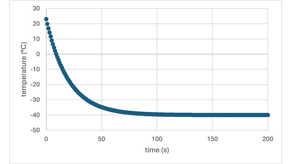

As an example, data of a decaying temperature response with noise is shown in Figure 3. It is desired that the data settle to 0.1 K before taking recorded samples. The sample rate is 1 s, and the data are broken into segments of 10 s (10 samples). A summary of the slopes of the first five segments is shown in Table 3.
Figure 3: Temperature Decay Data
Figure 3: Temperature Decay Data (Source: Fluke)

The mean plus two standard deviations of the τ values is 21.7 s. The largest value is used, since it will provide the worst-case scenario with this method.
The next question is how long to wait before the data is considered settled. In this case y0 = 22.99 °C and at t = 50 s, y = -34.75 °C. Estimating for yF:
estimating for yf
This value is slightly larger in magnitude than the true yF, since the estimate for τ includes some safety margin used for the worst case scenario mentioned above. The next step is to calculate tsettle.
tsettle=21.7[ln|22.99——41.15| —ln|0.1|]=21.7[4.16——2.30]=140.2 s

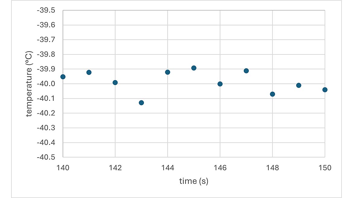

For these data, a look the first 10 seconds of data beyond t = 140 s is shown in Figure 4. These data show no slope beyond their noise floor.
Figure 4: Settled Data
Figure 4: Settled Data (Source: Fluke)

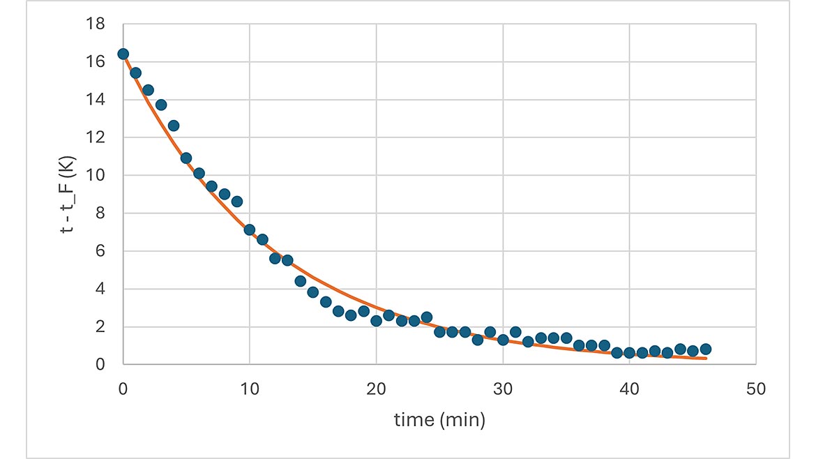

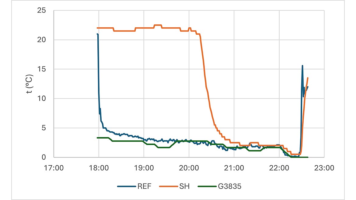

In some cases, the data either may exhibit too much noise or may have too small of a sample size rendering this method useless. To demonstrate this, a set of data that was used to determine the transient response of a thermal radiation instrument shield is considered. The data taken is shown in Figure 5, and shows the reference measurement (REF), data taken inside the thermal radiation shield (SH), and data from an adjacent weather station (G3935). The consideration of the transient started at 20:16. The decay constant is calculated by subtracting SH – REF.
Figure 5: Raw Data from Radiation Shield Testing
The subtracted data is shown in Figure 6. When using this method, the calculated values for τ varied too much to be useful. This is due to noise in the data. The noise in the data is due to two factors. First is the fact that the data is subtracted from two sensors that may have a different transient response. Secondly, and more of a factor, is the display resolution of the shielded thermometer was 0.5 K, which introduces quite a bit of noise to the data. Using other methods, the τ value was determined to be 11.8 minutes.
Figure 6: Transient Data
Figure 6: Transient Data from Solar Radiation Shield Testing (Source: Fluke)
