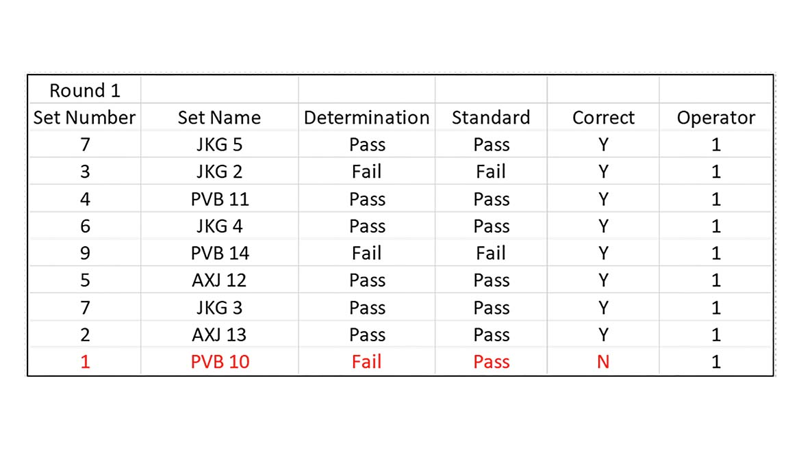

I always encourage the students and their project teams to select actual items from recent history to include in the MSA. For example, if the operators are going to evaluate inbound goods in a retail warehouse to determine whether they are assembled correctly, we will request recent items that successfully passed such an inspection as well as items that failed.
An MSA textbook will recommend that you use 10 different items and three operators, and that you ask the operators to evaluate every part two times each. My suggestion, in general, is to use nine or 12 parts for the study. One third of those parts should have a defect that is easy to identify, one third of them should have a defect that is tricky to identify, and one third should not have any defects at all. The reason for the clean parts is to detect false positives, times when the operator might fail a part that was actually acceptable. To help the operators forget how they scored each item in round one, the coordinator must allow sufficient time before round two.
Figure 1: Setting up a measurement study
Figure 1: Setting up a measurement study. Source: Tracy Owens
MSA Results

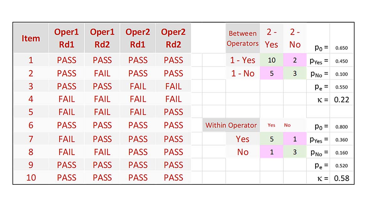

After all operators have evaluated all parts twice, it is time to conduct the analysis and learn how well the measurement system is working today. In a pass/fail study, like the completeness of a work order or information packet, there will be three numeric methods for evaluating repeatability, reproducibility, and accuracy. First is the percent agreement from the study that was just conducted. This will usually be a round number, like 80% or 90%, because there are so few samples being studied. But does that mean that, if we gave the operators 100 more parts to evaluate, they would be consistent exactly 80 times? No. Instead we calculate the second metric, which is the confidence interval.
Figure 2: Three numeric methods for evaluating a pass/fail measurement system
Figure 2: Three numeric methods for evaluating a pass/fail measurement system. Source: Tracy Owens
The confidence interval for a proportion is calculated statistically using a constant from the standard normal table, the sample size, and the proportion defective from the actual study. The confidence intervals tell us what the likely percent agreement would be if we did, indeed, give the operators 100 more samples to measure.
The third metric used to evaluate a pass/fail measurement system is the Kappa score, which is calculated not simply based on whether the responses were the same or not, like scoring “pass” in round one and “fail” in round two for the same item. Kappa scores also consider the direction of the mismatch, like saying “pass” when it should have been “fail” and saying “fail” when it should have been “pass”. A Kappa score of 1.0 indicates a perfect match, while a score of 0.0 gives the process the same chance as flipping a coin, like an operator saying, “if it’s heads, I’ll say ‘pass’”. A desirable Kappa score is between 0.9 and 1.0, and a Kappa score between 0.7 and 0.9 can be acceptable if the process is monitored closely.
Figure 3: Kappa calculator built by the author in Excel
Figure 3: Kappa calculator built by the author in Excel. Source: Tracy Owens
