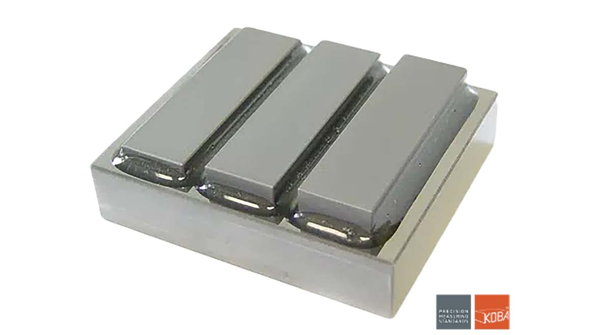

Opto-tactile Stepped Standards
Due to technical progress, the step standard has become one of the standard standards in optical and optical-tactile metrology. The field of application of the Optical Tactile Step Standards is in the calibration and verification of triangulation laser scanners, laser focus measurement systems and fringe projection systems.
Opto-Tactile Stepped Standards
Figure 1: Stepped Standards for opto-tactile applications
Figure 1: Stepped Standards for opto-tactile applications. Photo courtesy of Kolb & Baumann
See Figure 1 (above) Calibration standards based on gauge blocks with diffuse reflecting or shiny measuring surfaces. Made entirely of carbide and therefore corrosion resistant. Customer-specific designs are available within wide limits.
Field of application: Optical length and coordinate measuring systems such as
  • Triangulation laser scanners
  • Laser focus measuring systems
  • Fringe projection systems

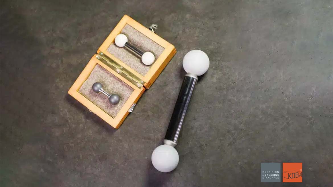

3D Calibration Standards
Figure 2: 3D calibration standards, i.e., dumbbells.
Figure 2: 3D calibration standards, i.e., dumbbells. Photo courtesy of Kolb & Baumann
See Figure 2 (above) Test specimen according to VDI/VDE 2634 made of optically cooperative ceramic materials. The specially selected materials allow optical and tactile measurements and thus the direct linking of the two measuring principles.
Field of application: optical 3D CMMs such as
  • 3D CMM’s with optical touch probes

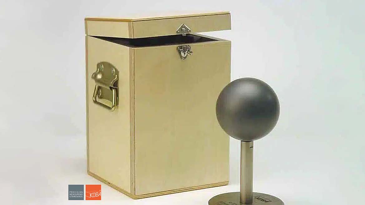

Sphere Standards
Figure 3: Sphere Standard.
Figure 3: Sphere Standard. Photo courtesy of Kolb & Baumann
See Figure 3 (above) Measuring spheres with diffuse reflecting surface in various designs. The spheres are made of carbide with a scratch- and corrosion-resistant surface that also allows tactile probing.
Field of application: Optical form and CMM’s such as
  • Video measuring systems

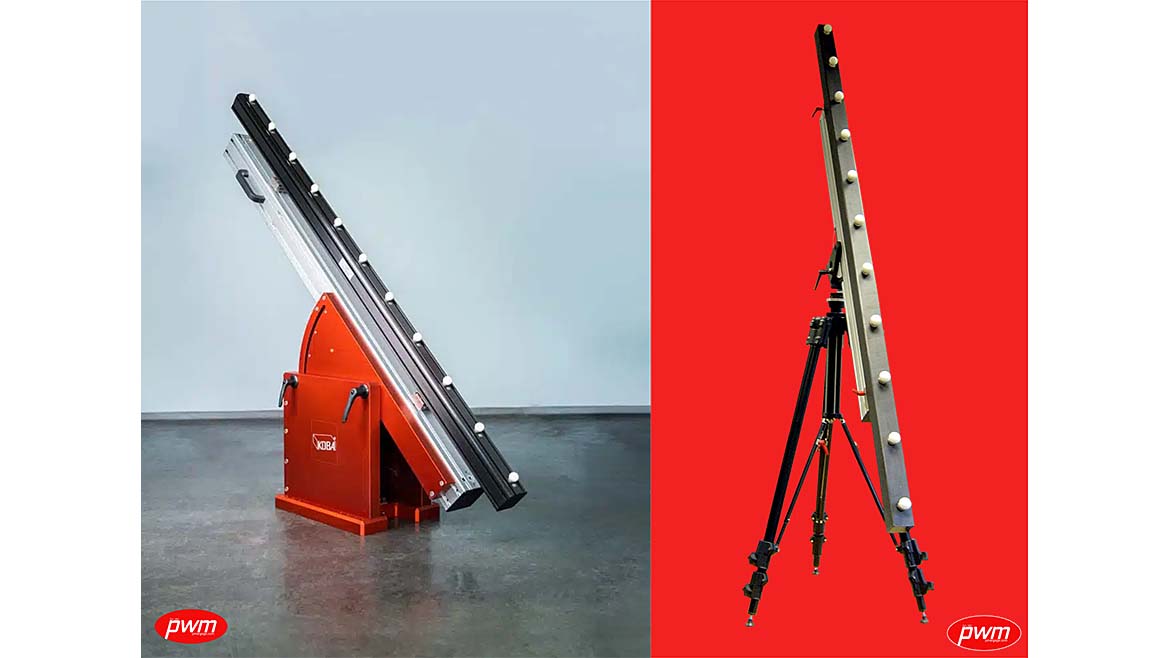

 Koba Sphere-Beam
Figure 4: Sphere Beam, shown with base (left) and tripod stand (right)
Figure 4: Sphere Beam, shown with base (left) and tripod stand (right). Photo courtesy of Kolb & Baumann
The KOBA sphere beam is a non-demountable sphere beam for monitoring and calibration of medium-sized CMMs. Ceramic spheres as probing elements, which are fixed in a stable position in a specially designed support, represent the long-term stable measuring lengths. Nominal lengths from 1,500 mm to 2,500 mm, with customer-specific pitches and ball diameters are available. Positioning of the KOBA sphere beam in a broad range within the volume of the CMM can either be made by using two light tripods in CFC or by a torsion-proof base on which a swivel arm is mounted.
Design Features:
 The base consists of an integrated profile made of the highest quality ultra-high-modulus carbon fiber. This CFC profile is extremely rigid and dimensionally stable due to its design and the manufacturing technology used. To prevent dimensional changes caused by humidity, the load-bearing body is additionally equipped with a water-vapor-proof coating.

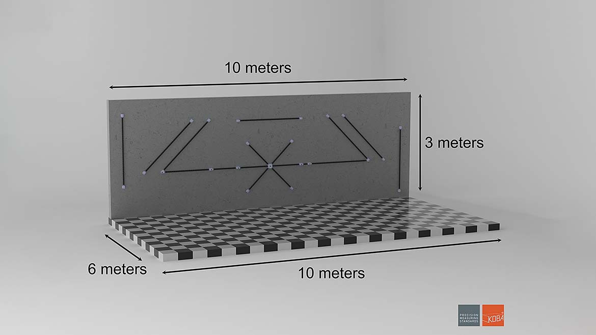

Artifacts for testing laser trackers.
Figure 5: Rendering of artifact developed by Kolb & Baumann for the State Institute in Thailand.
Figure 5: Rendering of artifact developed by Kolb & Baumann for the State Institute in Thailand. Photo courtesy of Kolb & Baumann
Kolb & Baumann GmbH & Co. KG, leaders in the development of calibration standards, developed a large capacity artifact for verification of laser trackers (see figure 4, above).
According to Martin Wombacher, Technical Manager Head of DAkkS Laboratory D-K-15077-01-00 of Kolb & Baumann GmbH & Co KG, he suggests:
"The acceptance and calibration of laser trackers and tracers is a highly specialized topic. Suitable test specimens are calibration beams with 3-point holders (nests, with or without holding magnets), which must be calibrated according to the center distances when used with the 1.5" SMR. Various manufacturers offer standardized fixtures and reference beams with a maximum length of 2,300 mm. However, as these measuring systems are generally used for very large measuring volumes, acceptance or calibration with these relatively short reference bars does not fulfil the requirements of ISO 10360. This standard requires that the reference bar covers at least two thirds of the measuring volume diagonals. The Physikalisch-Technische Bundesanstalt has also installed a "calibration wall", similar to the one they developed for the State Institute in Thailand, with a fixed arrangement of 3-point recordings. This artifact is approximately 10 x 3 meters in size, with a chessboard-like positioning area measuring 10 x 6 meters, in order to accommodate a wide variety of measurement volumes."
