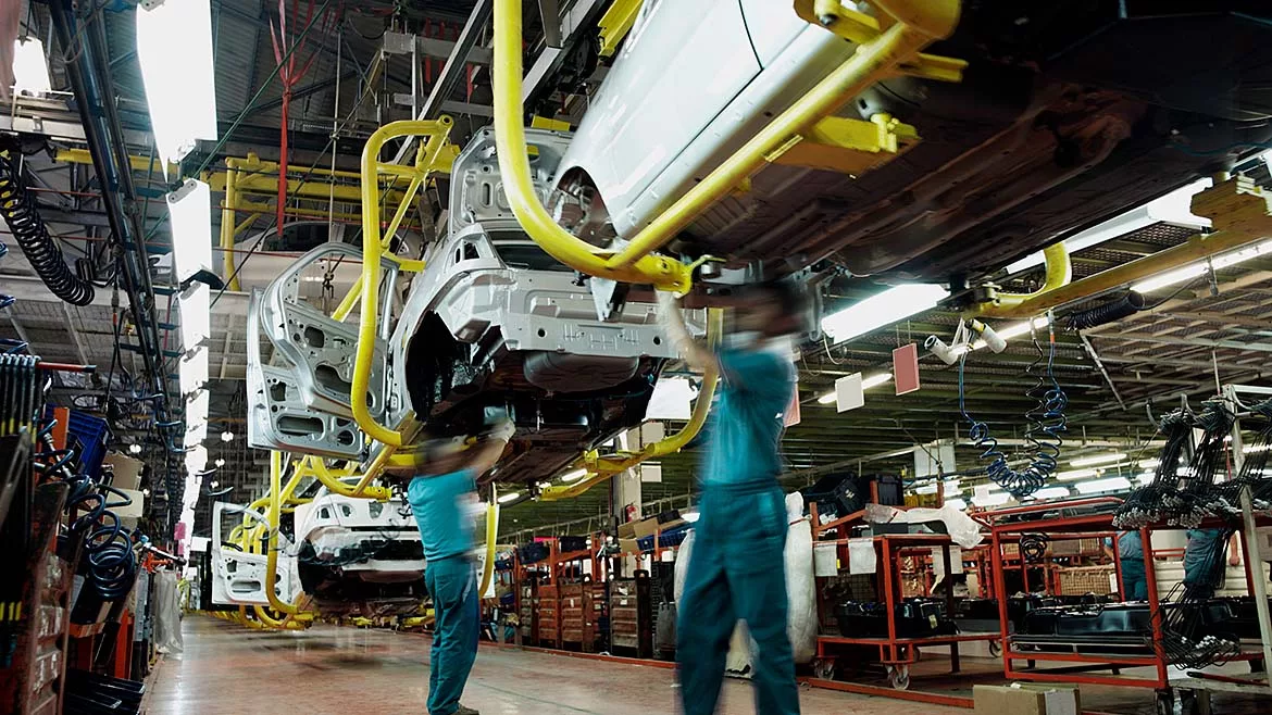

The image depicts human workers assembling a vehicle on an automotive production line
