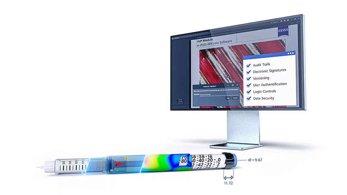

The image displays the ZEISS ZEN core microscopy software with its GxP Module
Source: ZEISS Industrial Quality Solutions and Sai Ranjith Ramakrishnan Kumar

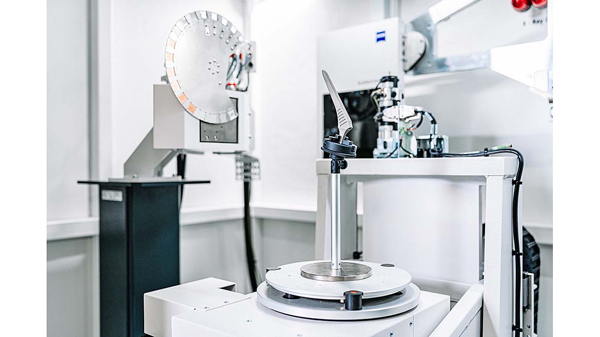

This is a ZEISS METROTOM 800 320 kV industrial computed tomography (CT) system
CT technology supports innovation in the medical industry by enabling comprehensive analysis of complex parts through digitalization.
Carrie Pfeifer, applications engineer at ZEISS Industrial Quality Solutions, said manufacturers often work directly with measurement equipment suppliers to establish validation approaches that fit their products and risk profiles. FDA standards outline what a quality management system must achieve, she said, but do not always explain how to apply advanced measurement technologies in practice. That leaves manufacturers responsible for demonstrating that their inspection methods produce reliable, defensible results.
