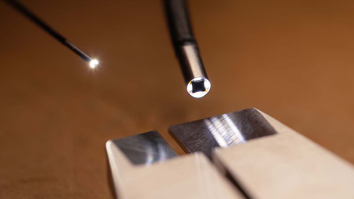

Optical extension tools represent the most basic form of remote viewing. Mirrors and magnifiers extend visibility into partially obstructed features without electronic imaging. These tools are simple, durable, and usually cost-effective. However, they cannot navigate enclosed or deep internal features, do not support image capture for documentation, and depend heavily on operator positioning and lighting conditions.
Fiberoptic borescopes transmit images through coherent fiber bundles from the inspection tip to the viewer. Illumination is delivered through surrounding light-transmitting fibers that project light onto the internal surface. Because no electronic sensor is housed at the distal end, fiber-based systems are often favored when access diameters are extremely limited. In applications where openings approach 2 mm or smaller, fiber probes may provide the most practical solution. However, image resolution is limited by fiber count, and the fiber bundle is susceptible to damage or breakage with repeated use.
A 0.5 mm-diameter fiberoptic borescope
Pictured: A 0.5 mm-diameter fiberoptic borescope (left) with a 2.0 mm-diameter video borescope (right) with measuring calipers spaced at 1.0 mm for scale.
Image Credit: InterTest
Video borescopes incorporate a miniature CMOS image sensor at the distal tip and transmit the image electronically. Illumination is typically provided by integrated white LEDs, with UV sources used in specialized inspections; in very small probes, light may be delivered through fiber guides. Because the image sensor must be physically housed at the tip, the minimum diameter of a video borescope is constrained by the size and packaging of the CMOS sensor. As a result, video probes generally cannot achieve the same extremely small diameters as fiber-optic systems. When access openings are approximately 2 mm or larger, video-based systems become more broadly applicable and offer advantages in image capture, documentation, and adjustable viewing parameters.

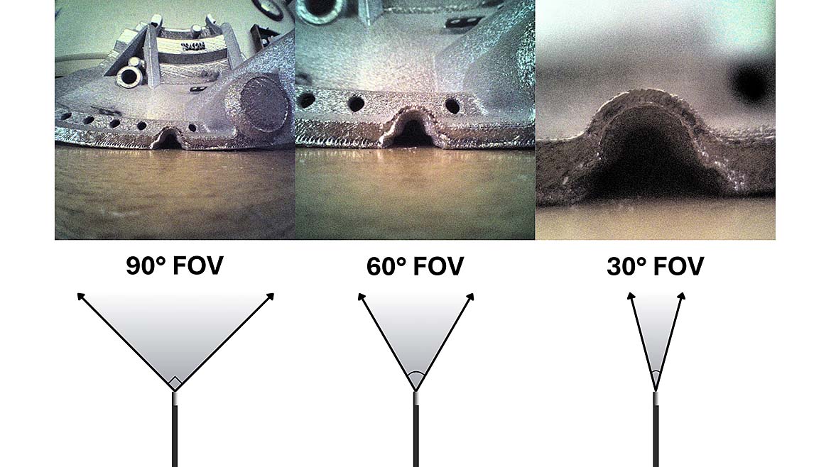

Field of view (FOV) directly affects inspection efficiency and defect visibility. A wider FOV increases surface area coverage and reduces repositioning time, provided resolution remains sufficient. A narrower FOV increases apparent detail but limits coverage and may require additional probe movement. Selecting the appropriate FOV requires balancing efficiency with the ability to resolve the smallest defect of concern.
1500 x 1500-pixel CMOS video borescope image comparison
Pictured: 1500 x 1500-pixel CMOS video borescope image comparison (3) with scope-tip-to-target at same distance of ~0.50 inches. Different FOVs showing different apparent detail.

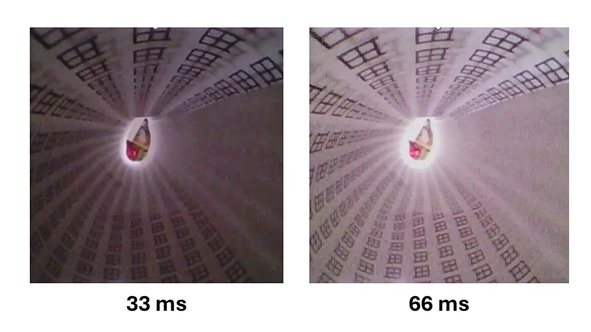

Illumination also plays a critical role. Insufficient light within deep bores or internal passages can obscure fine detail and compromise inspection accuracy. Reflective machined surfaces may also create glare if lighting is poorly controlled. Proper light intensity, balancing, and image processing are essential to ensure that surface conditions are represented clearly and consistently.
Side-by-side 700 x 700-pixel CMOS video
Pictured: Side-by-side 700 x 700-pixel CMOS video borescope images with white LED-illumination intensity held constant. Exposure time set @ 33 milliseconds (left)  versus exposure time set @ 66 milliseconds (right). Doubling exposure time increases apparent illumination and unveils more detail.
Effective RVI depends on integrating FOV, DOF, illumination, and documentation requirements to produce reliable, decision-grade images.
