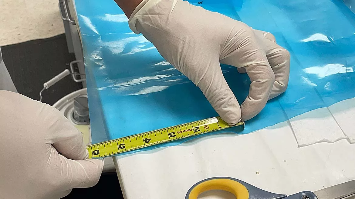

VIA test equipment
VIA testing requires a few simple components (left to right): VCI source (e.g., VCI film strips), lid with steel plug holder, steel plug, jar containing water/glycerin solution. Image Source: Cortec
VIA Testing
VIA (vapor inhibiting ability) testing can be used to check VCI (vapor corrosion inhibitor) packaging materials for effectiveness. VCI packaging includes films, bags, papers, and other materials that emit corrosion inhibiting vapors. These vapors are attracted to metal surfaces where they form a molecular layer of corrosion inhibitors, eliminating the need to directly apply a grease or liquid rust preventative that must be removed later. Because the parts are protected in a clean, dry manner, they can be installed or used immediately after being taken out of the package.
VIA test setup.
VIA test setup. Image Source: Cortec
The basic VIA testing concept comes from military guidelines that have been around since the 1970s and have crystalized into official standards such as AMPP’s NACE TM0208-2024[1] and German test method TL-8135-002.[2] Equipment varies slightly depending on whether manufacturers want to strictly adhere to NACE TM0208-2024 or want to do a simpler modified version. The test is performed in a glass jar with a special lid that holds a steel plug. A water/glycerin solution goes in the bottom of the jar, and a source of corrosion inhibiting vapors—whether VCI film, paper, or emitter—is suspended from the lid without directly touching the metal plug or the liquid (see images 1-3). The container is left overnight to allow time for the vapors to fill the jar. The next step in the AMPP standard is to pour ice cold water through a hole in the lid connected to the backside of the steel plug, then immerse the entire jar into hot water to induce condensation. A modified version of the test produces condensation by placing the jar into an oven for two hours then removing it for two hours before examining the plugs. Both the official and modified VIA tests are completed by grading the steel plugs on a scale of 0 to 3. A grade 0 plug with many corrosion spots represents failure, while a grade 3 plug showing no corrosion spots represents good corrosion protection. Although VIA testing can be performed by an accredited lab, it is a relatively simple method for manufacturers to set up on site if they want to confirm the effectiveness of each incoming batch of VCI material. This is a wise idea since many manufacturers outsource VCI film or paper production and may never test the products for vapor inhibiting ability.
