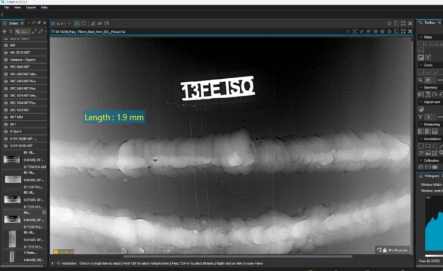

Like all digital X-ray systems from DÜRR NDT, the bendable detectors are also operated with our proven D-Tect X inspection software. Special and easy-to-use functions such as multi-gain calibration always ensure the highest possible image quality. Powerful and intelligent tools, such as the X-filter for fast image optimization, make image evaluation simple and efficient.
