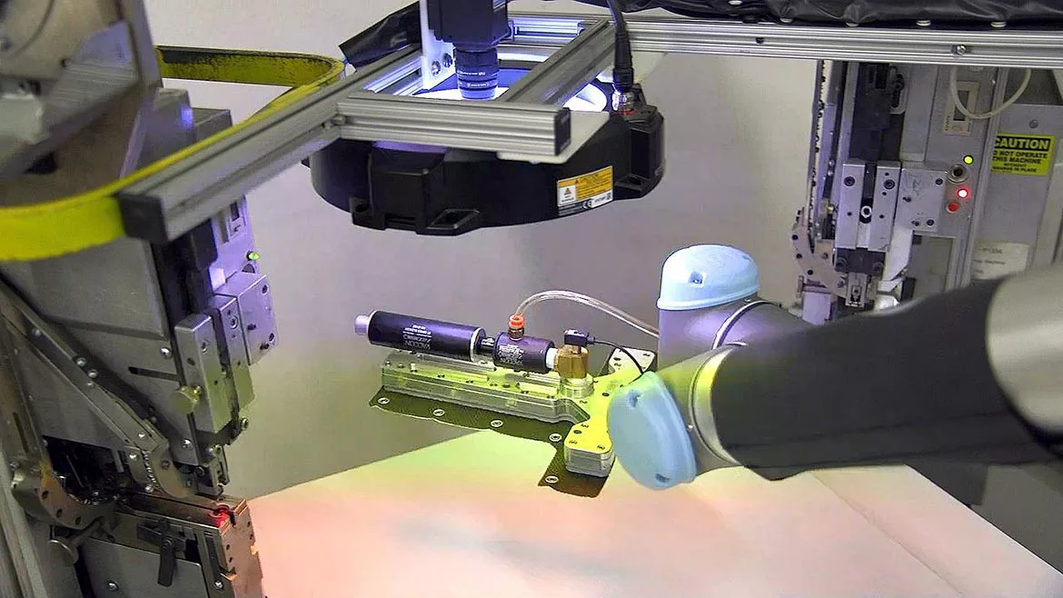

With no robotics experience, the family-owned Zippertubing Company in Arizona integrated a UR5 cobot from Universal Robots in vision-guided applications tending snap fastening machines for wrap-around cable jacketing. The UR5 picks up pre-cut fabric material that the cobot moves through a snap-set machine where five male snaps are inserted, then it moves over to a second machine where five female snaps are added. The 25 second cycle concludes as the UR5 presents the piece to a vision camera that inspects whether the snaps are added correctly. Depending on outcome, the UR5 is directed to place the finished piece in either the “good” or the “scrap” pile.

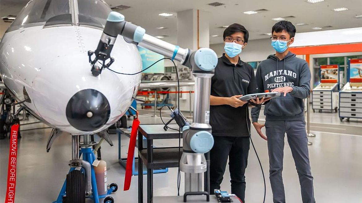

Nondestructive testing (NDT) is an inspection methods used to identify cracks or defects in materials, or determine the elemental composition of materials without damaging it. Olympus, a Singapore-based leading manufacturer of test and measurement solutions, has a wide range of NDT devices widely used in scenarios such as inspecting aircrafts. This type of inspection is an essential part of ongoing maintenance programs to ensure the integrity of the aircraft for crew and passenger safety. Image Source: Universal Robots

Automated inspection doubles production output at Zippertubing
Arizona-based Zippertubing Company originally deployed a cobot to help in the assembly of wrap-around cable jacketing used in the automotive industry. The family owned firm, which was completely new to automation at the time, quickly grew so comfortable with the cobot that they confidently added vision guidance to the cell, enabling fast and automated inspections and rapid transfer of product to ‘reject’ and ‘good’ bins as appropriate. With cobots able to run all night, Zippertubing doubled its production output and freed workers to focus on more skilled and satisfying tasks.

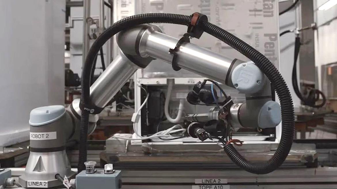

Bosch Siemens Hausgeräte (BSH) a leading European home appliance manufacturer, deployed MIRAI AI-vision software from Micropsi Industries on a Universal Robot to automate end-of-line refrigerator leak testing. Image Source: Micropsi Industries.
AI-powered inspection detects refrigerator leaks at Bosch Siemens
Simple inspection checks like the one Zippertubing deployed don’t require much in the way of AI or machine learning, but many cobot-based applications do.
Bosch Siemens Hausgeräte (BSH) a leading European home appliance manufacturer, deployed MIRAI AI-vision software from Micropsi Industries on a cobot to automate end-of-line refrigerator leak testing.
The process involves running a sniffer probe along the solder joints of coolant pipes on the back of refrigerators, a serious challenge considering that each pipe is uniquely positioned and its solder joints vary in shape and color. It’s a task traditional automation couldn’t handle due to the variation.
Using the MIRAI vision system, the cobot can detect solder joints and guide the sniffer probe accordingly. The solution lowered BSH’s ongoing operating costs, boosted quality and reduced maintenance and troubleshooting.

Nondestructive testing (NDT) is also possible using cobots. Singapore-based Olympus has a wide range of NDT devices that allow end-users to conduct inspections, detect defects, measure thickness or elemental compositions in a range of materials. Olympus’ NDT equipment is widely used for aircraft inspection in Singapore, a regional aviation hub. When integrated with a cobot, it is possible to automate NDT processes such as ongoing maintenance program for aircraft and verification of precious metals using the X-ray fluorescence and ultrasonic methods.
