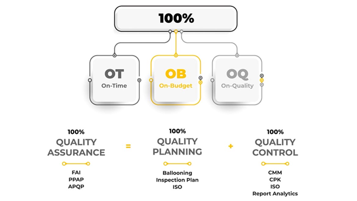

However, QP & QC together present a business dilemma: Striving for perfection in both areas will be too costly and take too long.
Infographic of On-Time, On-Budget and On-Quality
Image Source: www.highqa.com
On-the-job experience and strong core skills are critical for accelerating the quoting process. Skilled quotation engineers can quickly spot features that will present challenges. Similarly, Quality planners (QP) excel at sifting through dense documentation to spot the fine print that could get a company into hot water later down the line.
The reality is—we need both perspectives in the room when reviewing new parts or packages. This collaboration needs to be seamless. Avoiding surprises is paramount to speeding up and streamlining the entire process. As the old saying goes, “Measure twice, cut once.” By the time the purchase order (PO) arrives, it’s often too late to address overlooked details. Conversely, if it takes a week to send a quote, customers will move on to other suppliers. Striking the right balance between speed and thoroughness is key.
