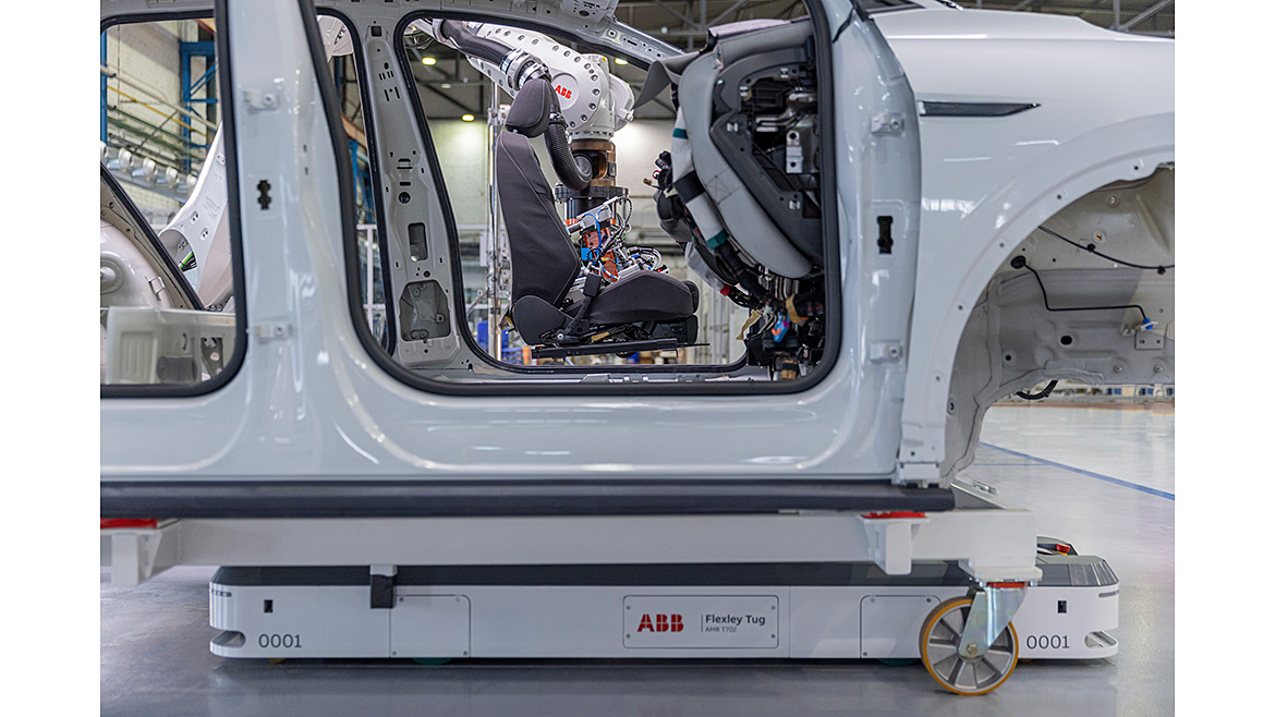

Tug AMR Auto
In automotive production, Visual SLAM is helping to phase out fixed conveyor lines in favor of modular production cells served by intelligent AMRs. Image Source: ABB Robotics
